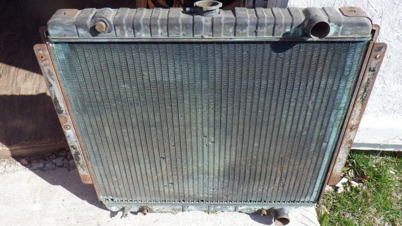

Old Mar 30, 2022 | 05:44 PM
Daves69's Avatar
Daves69
Joined: Dec 2012
Posts: 355
Likes: 6
From: Chi - west
The passenger side water intakes were always a PITA.
This radiator was out of my '74 Trailduster 440 if it helps. Still in the shed lol.....
