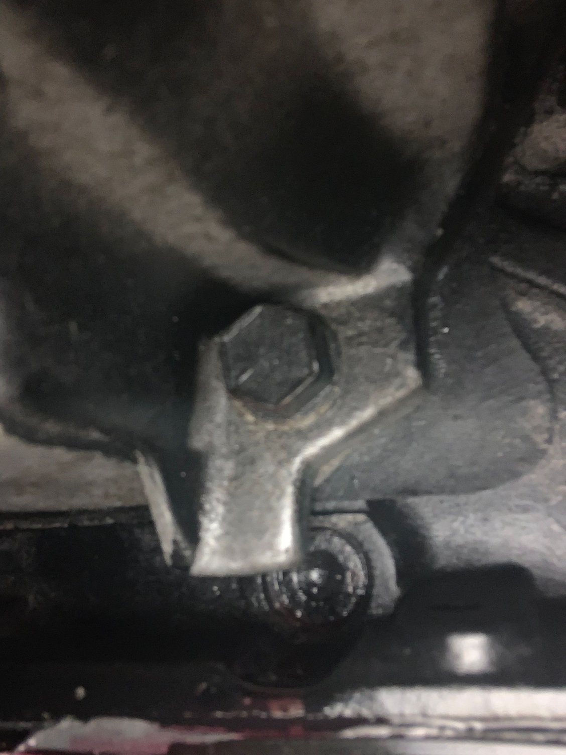

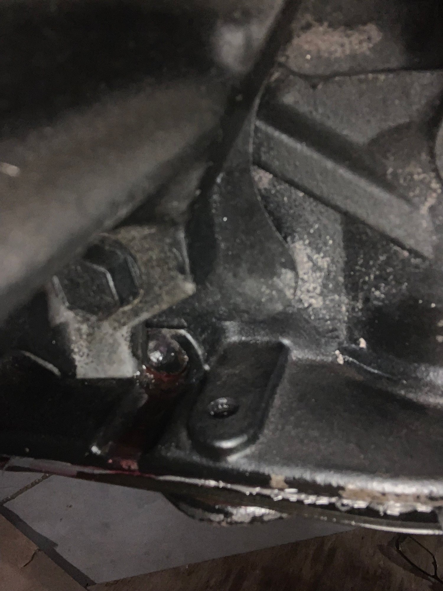

I have a leak on the back of the 727 transmission body. The bolt head you see is bolting the tailstock (?) to the body. The leak is at the round thing just below. What is the round thing and what’s the fix?

That is the pin that has a O-ring seal for the reverse anchor that the band and strut are connected too. You don't need to remove the transmission. But you will need to remove the tail housing and valve body. The loosen up the reverse band.
