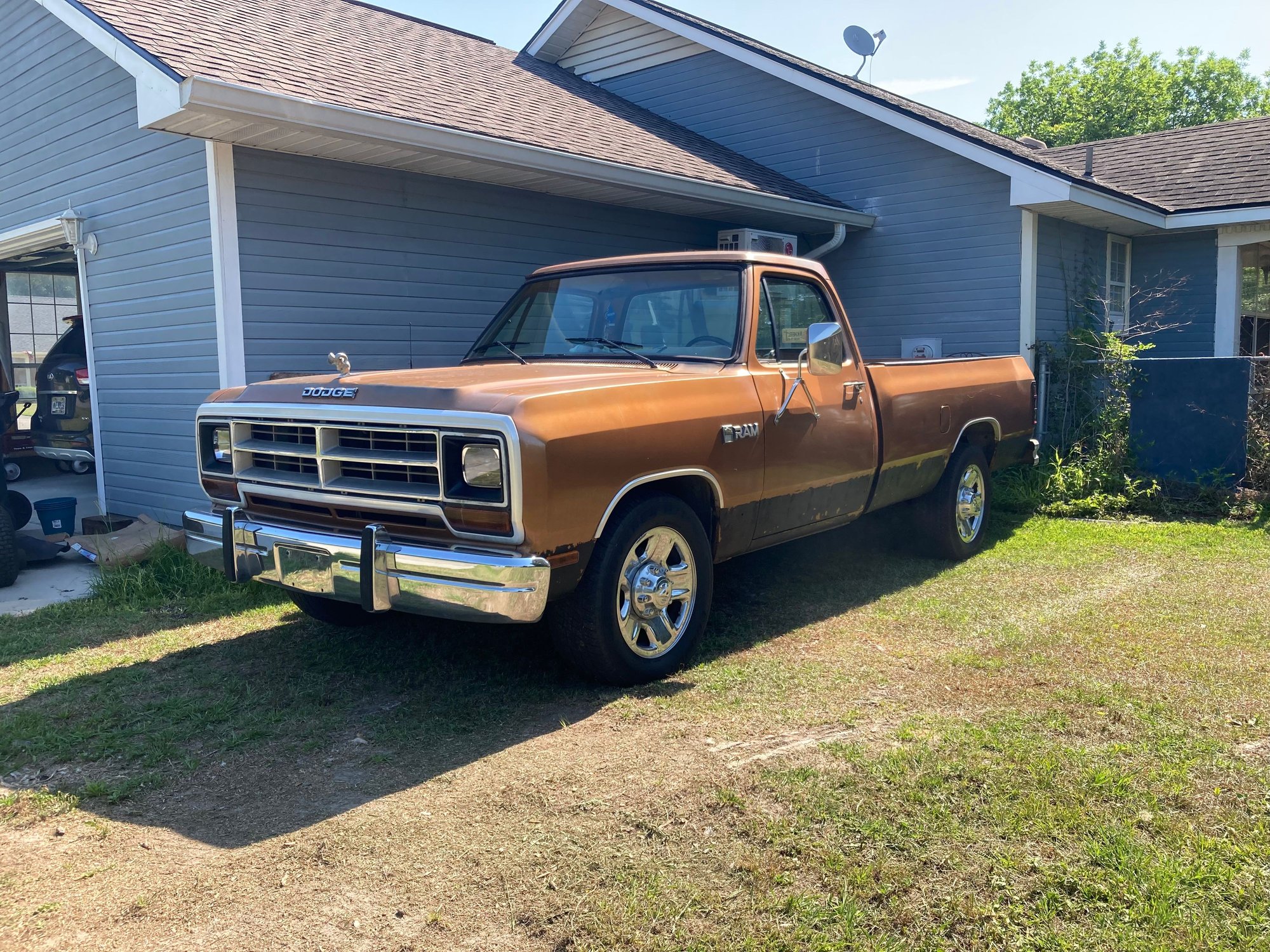

I have a 1986 Dodge Ram D250 with the 5.9L 360 V8 with I think the TF8/727 transmission stock quadrajet carb. emissions removed
I’d like to see what kind of power upgrades I can do to it because as of right now it’s barely enough to get out of its way with a 0-60 of 16 sec… truck runs like a dream… just need some more power thanks in advance
