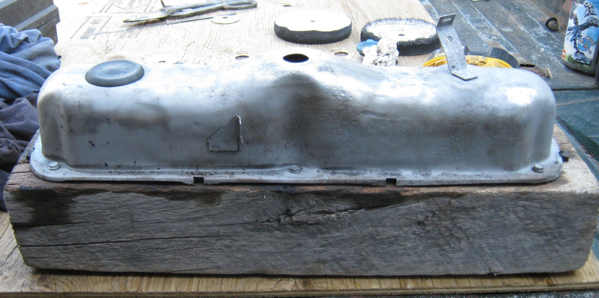

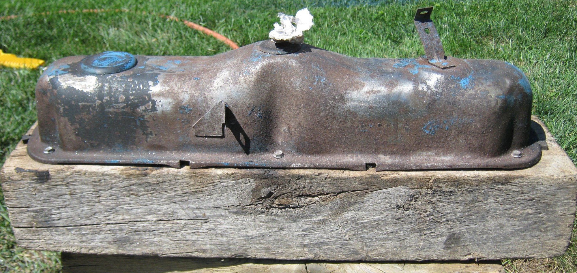

it is really not that hard to clean up or re-finish stock valve covers but if you do just make sure to get all new seals. i usually sandblast mine after pressure washing any crud off them. make sure to save the old gaskets if you do. it make securing the valve covers to a block of wood easier. as far as aftermarket valve covers go i am pretty sure most i have seen require modification to suite most applications. most usually only have 1 hole per side. i got a set on my 1 vehicle and 1 side has the pcv and the other side has the breather. to fill the oil i pop the breather out to add oil and put it back in when done. if you do paint your own valve covers make sure to use engine enamel since it is usually oil and gas resistant.
