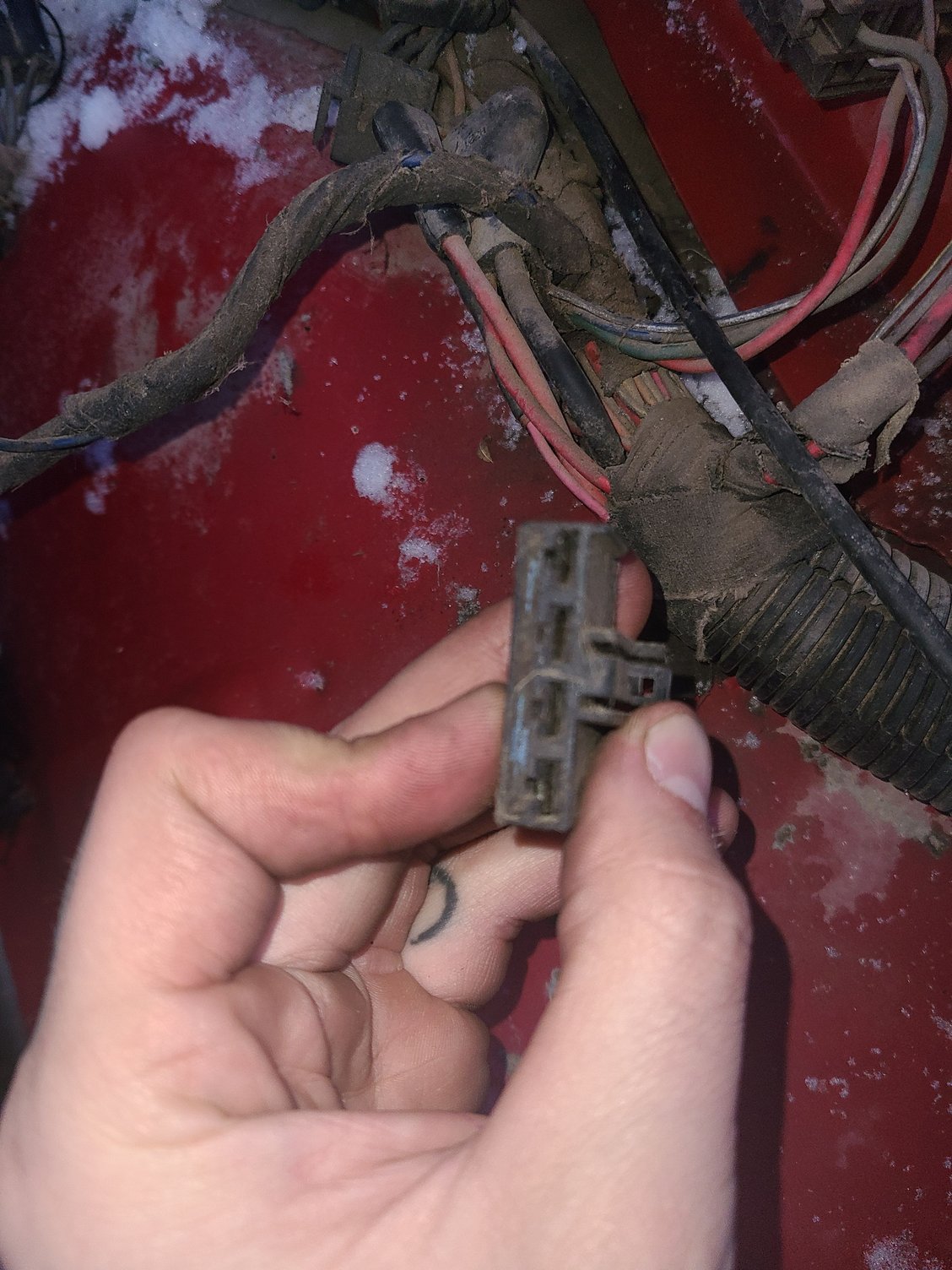

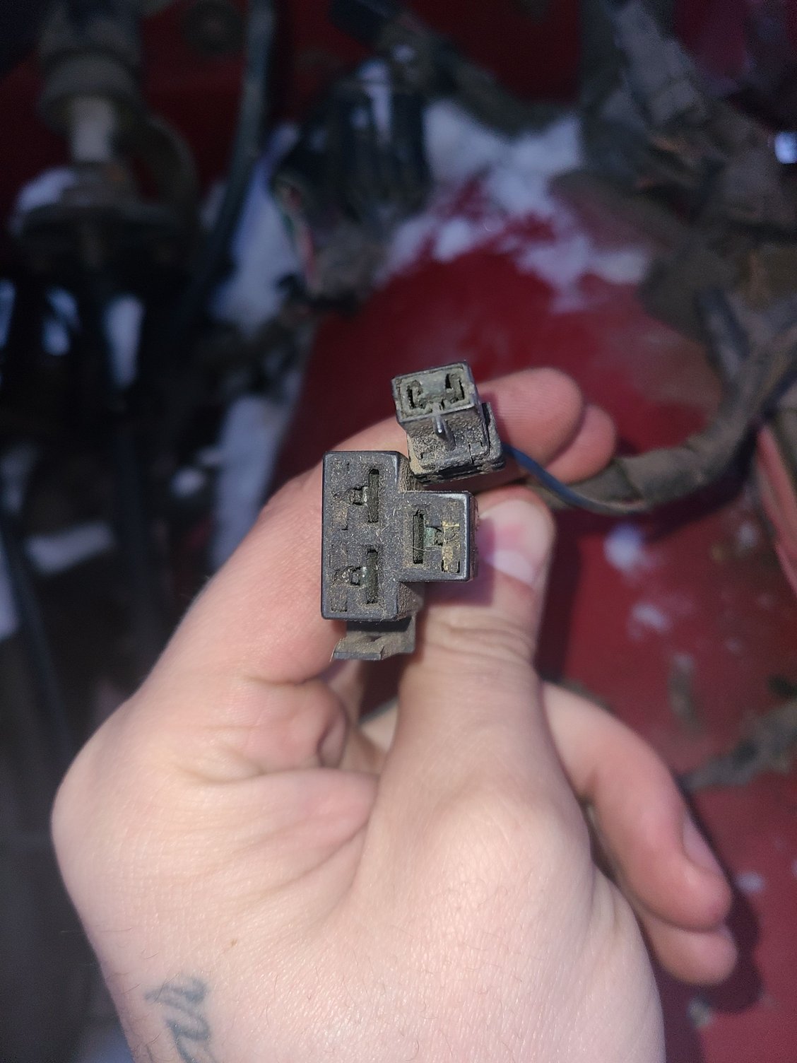

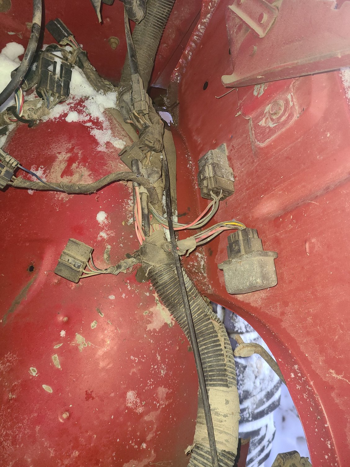

Hello there, I am hoping to get some help on a couple issues I have with a new truck I bought (89 dodge w150)
Major issue at the moment is that it won't start. It just clicks. Looking under the hood I've noticed some unplugged connectors. So it seems to be missing something but I'm not sure what. Could anyone point me in the right direction.

Given how dirty those connectors are, I suspect they weren't plugged into anything.
How is the battery? Where do you hear the click from? Relay? Or solenoid down on the starter?

Battery is good. I'm able to jump the starter solenoid and crank it. Click comes from the ignition so it might not be anything actually. Everything has power but turning the key doesn't seem to do anything.

Long story short, an ohm meter sent me chasing ghosts. Turns out it was super simple. I believe it's the neutral safety switch, the connector wasnt plugged in. Thanks for the replys tho!
