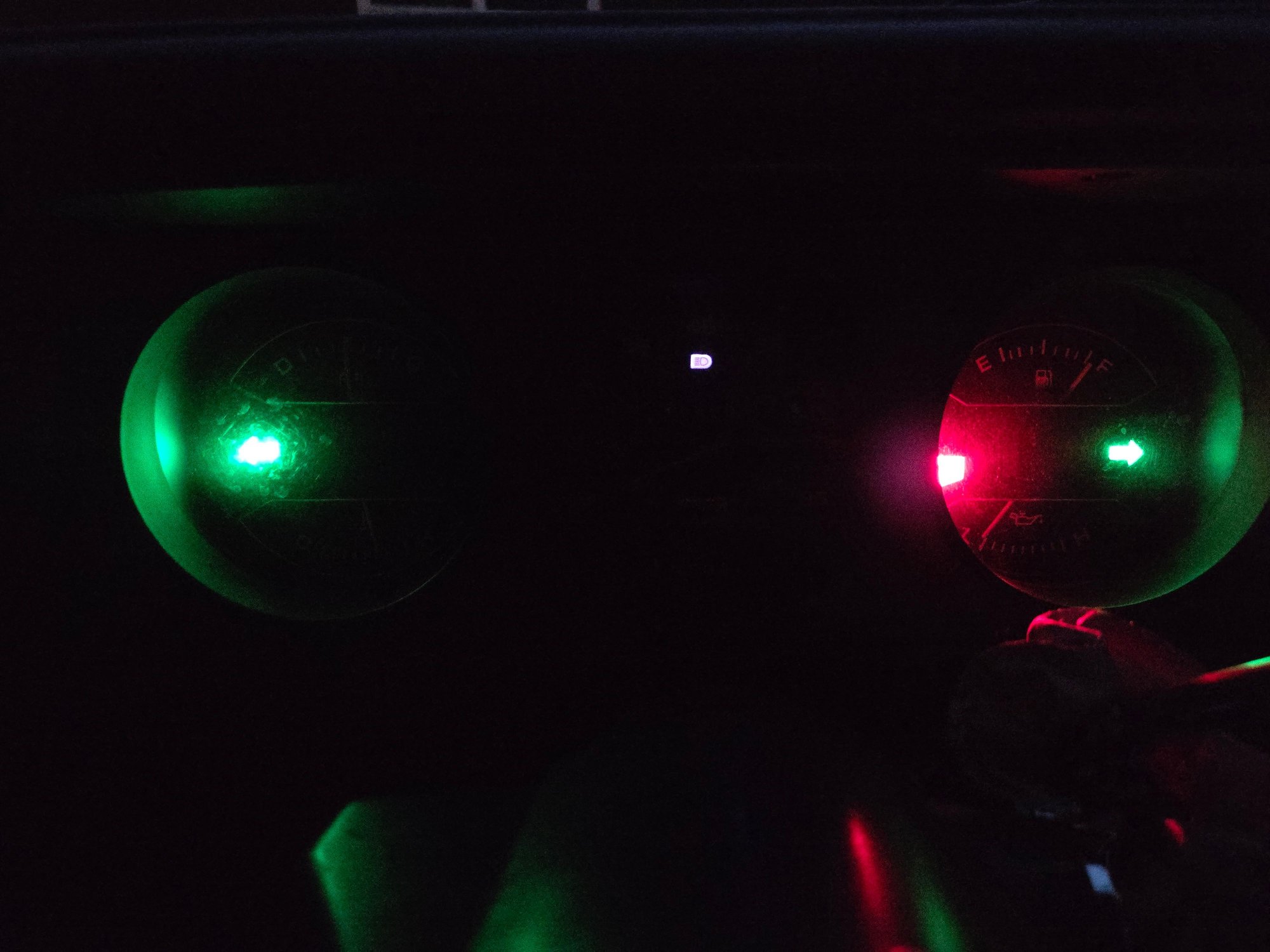

If I turn on either of my turn signals then it turns hazards on the dash, but left turn signal will only put the left on outside while the right turn signal will turn on both sides outside.
Headlights do not work at all and the turn signals quit working if I turn on the headlights.
Turn signals turned on without the headlights
Headlights turned on with or without turn signals
Any help here would be much appreciated

Bad ground somewhere. Possibly a failed bulb in the turnsignal/park lamps as well.

Front right turn signal bulb has been out for a while but everything else was still working, could that start to affect other lights?

Do the hazards work? High beam on the headlights?
