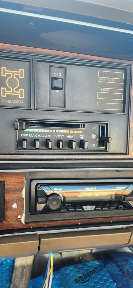

Thats good to hear you've been able to source things. As I continue to look im also seeing more options out there as it pertains to universal condensers and custom hoses. I also originally mispoke, I thought I had flare hose ends but they are actually female o-ring fittings, I believe #6 and #8. Which appears more common with condensers, so that's a relief. Here's my dash control:

Ok that looks like one used for factory air
that's weird as those years as I remember factory hoses were a flat flange with 2 lines and a stud in the center.
how long have you had the truck who knows what has been done to it from new to when you got it .. who knows what a past owner has cobbled together? As has been said there are places that will make up any hose you can imagine. And a lot of times they'll use universal hose barbs and hose clamps. Are your fitting crimped where they would connect to the condenser?

I haven't had the truck very long, so I'm in the fact finding stage of ownership at the moment. You're right there's no telling whats been done. I was able to verify thru decoders that the engine I have is indeed the correct size sold with the truck, but ive been unable to find the stamp to verify it is the original engine, im assuming it is. Im attempting to accurately decode the compressor stamp at the moment. Also in my Haynes manual it mentions the possibility of having two types, but didnt elaborate further. The changes begin at the expansion valve, as you can see it has 2 hoses coming out of it instead of a block connector. Then to the dryer, which also has threaded connectors, instead of block connectors. The compressor hose and dryer hose to the condenser are shown. The smaller one looks rebuilt at one point, the other looks original.
