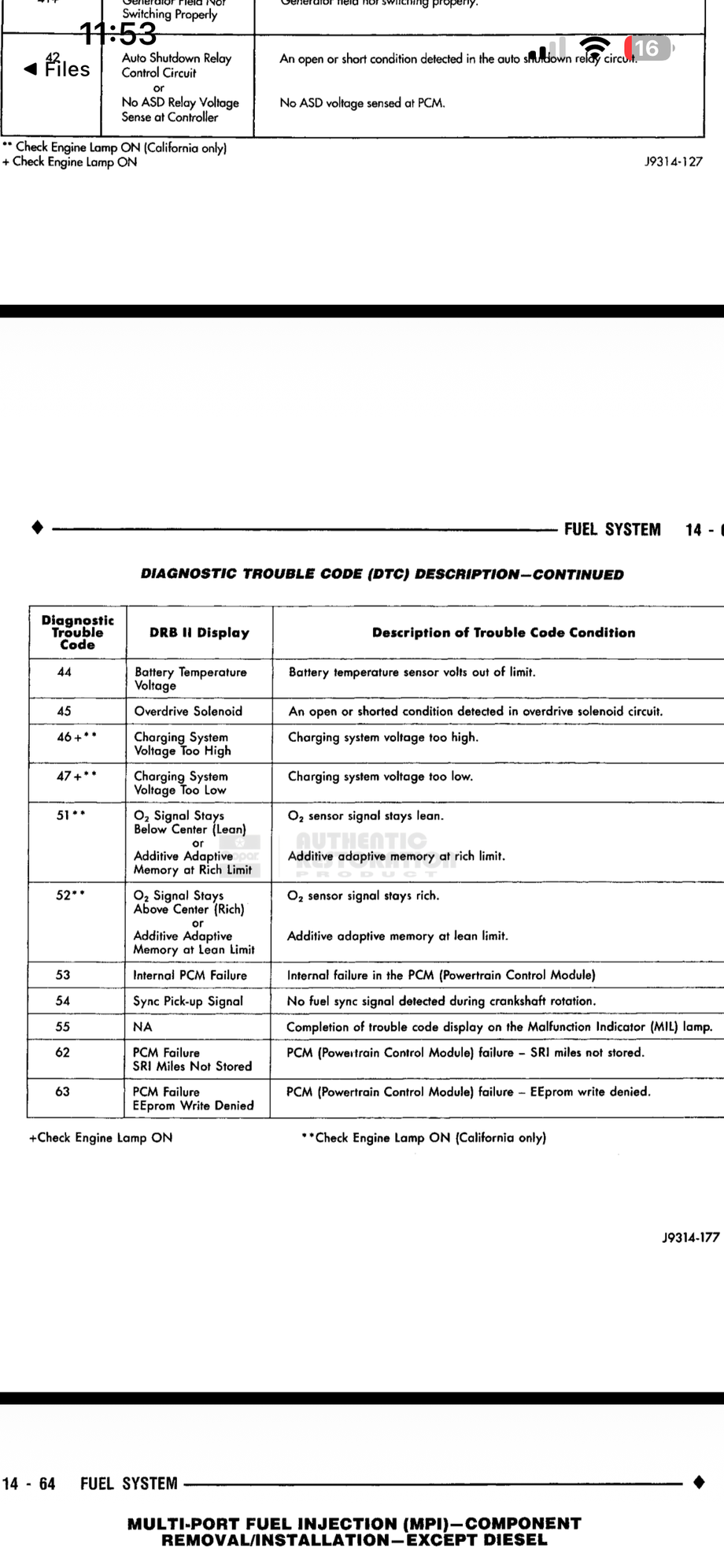

the code it gave was 54 unless I counted wrong. 54 is for fuel sync from crank sensor.

54 would be for the cam position sensor, not the crank sensor. It's in the distributor, just under the cap/rotor, and is more commonly referred to as the 'pickup coil'.....

It helps to read the whole description.
54 Internal logic module fault ('84 turbo only) - or camshaft sensor/distributor timing
