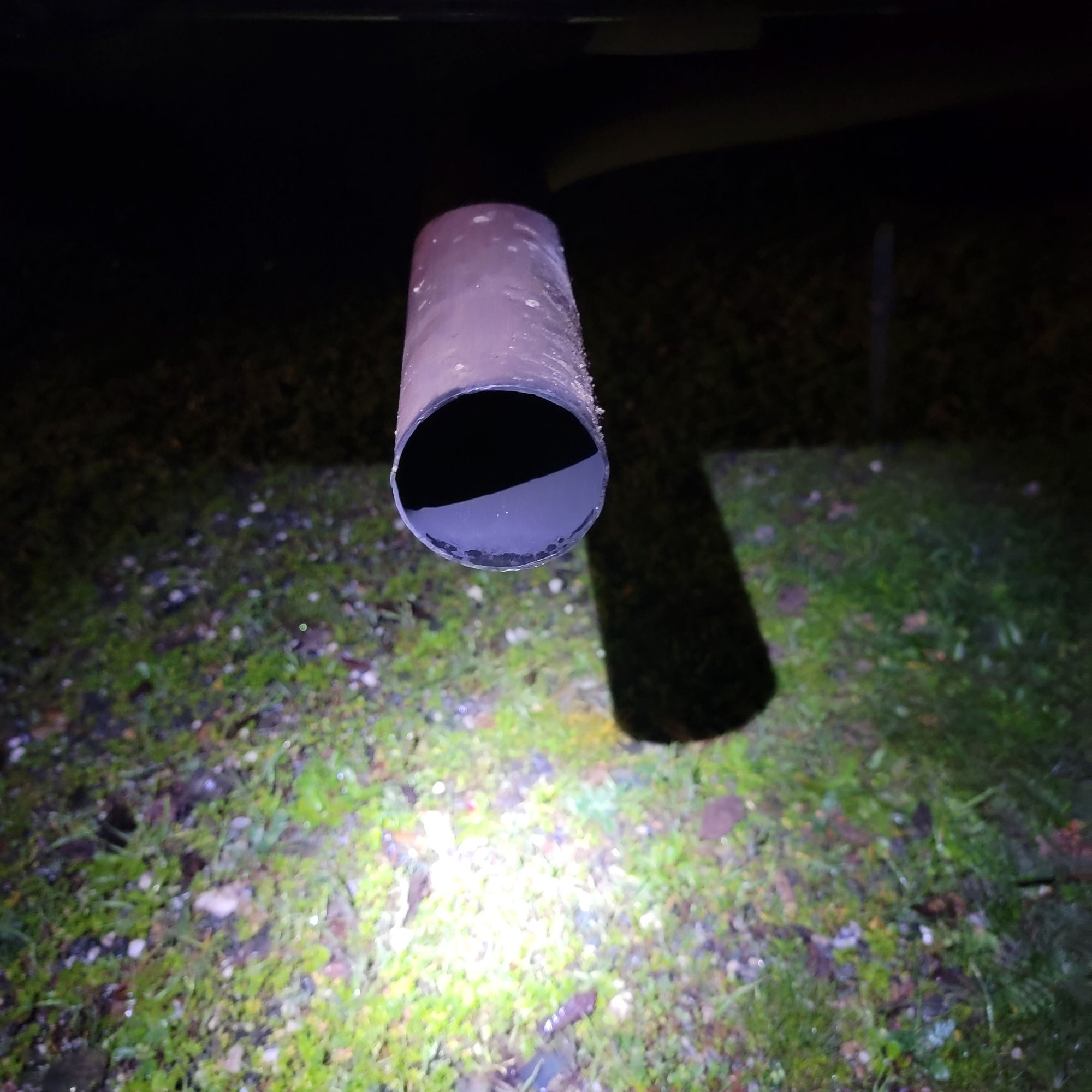

This my tailpipe.
Raining in the dark. Shows a little black?

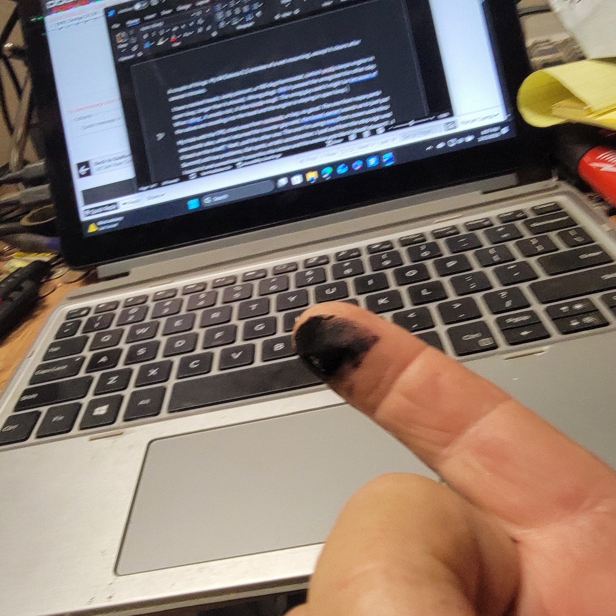

Not much oiliness, just more soot than it should be.
