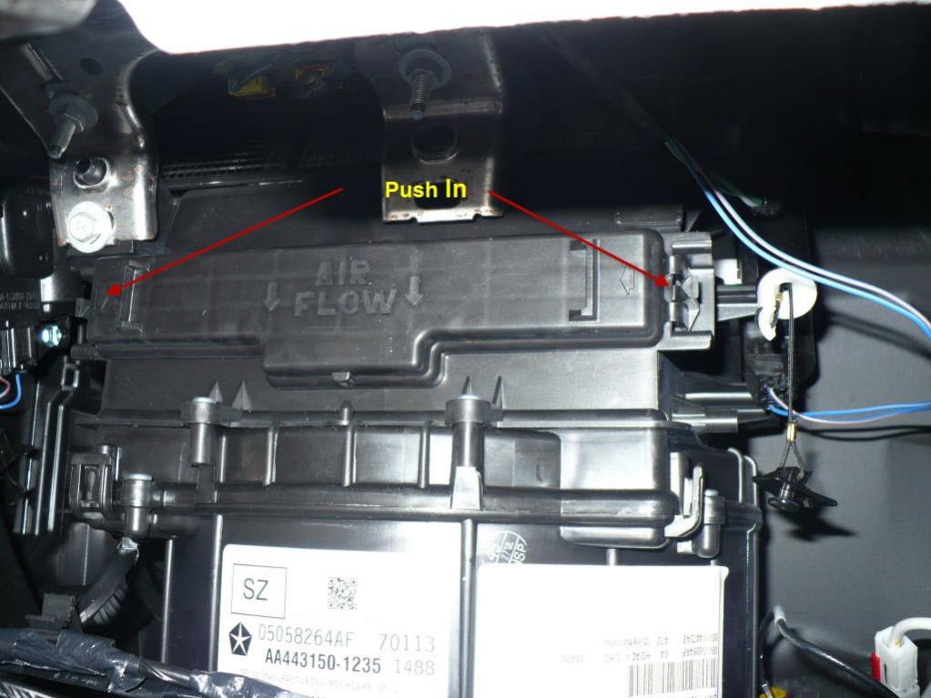

Does anybody have a pic of the location on an 08 Avenger, I am looking behind the glove bx but I can't see any place that would hold a filter.

I didn't think there was one.

I have the new filter in hand and I am sure I had a garage replace it befor.

Look for the arrows, the filter slides in...
- Dan M

Is this behind the glovebox? My car smells musty when I turn on the ac so thinking this must need replacing?

Yes I just found it and mine was starting to smell that way to so that is why I am replacing it tonight, and the filter is quite dirty, it just shows how much is going through the car with out them.

Yes Napa, go in and ask them for a cabin filter part # 4578 for a caliber or jeep compass, it fits and it is half the price, about 16.00 bucks

I picked up mine from a local branch of federated auto. It's made by hastings and was around $14. Same filter in my 08 avenger as my 09 patriot.

They don't advertise a filter for the 08 but it has the location, now my ram doesn't have the location until you get crafty and cut it out with a knife buy the door and filter for the Caliber and you will be all set...same one fits Avenger.
