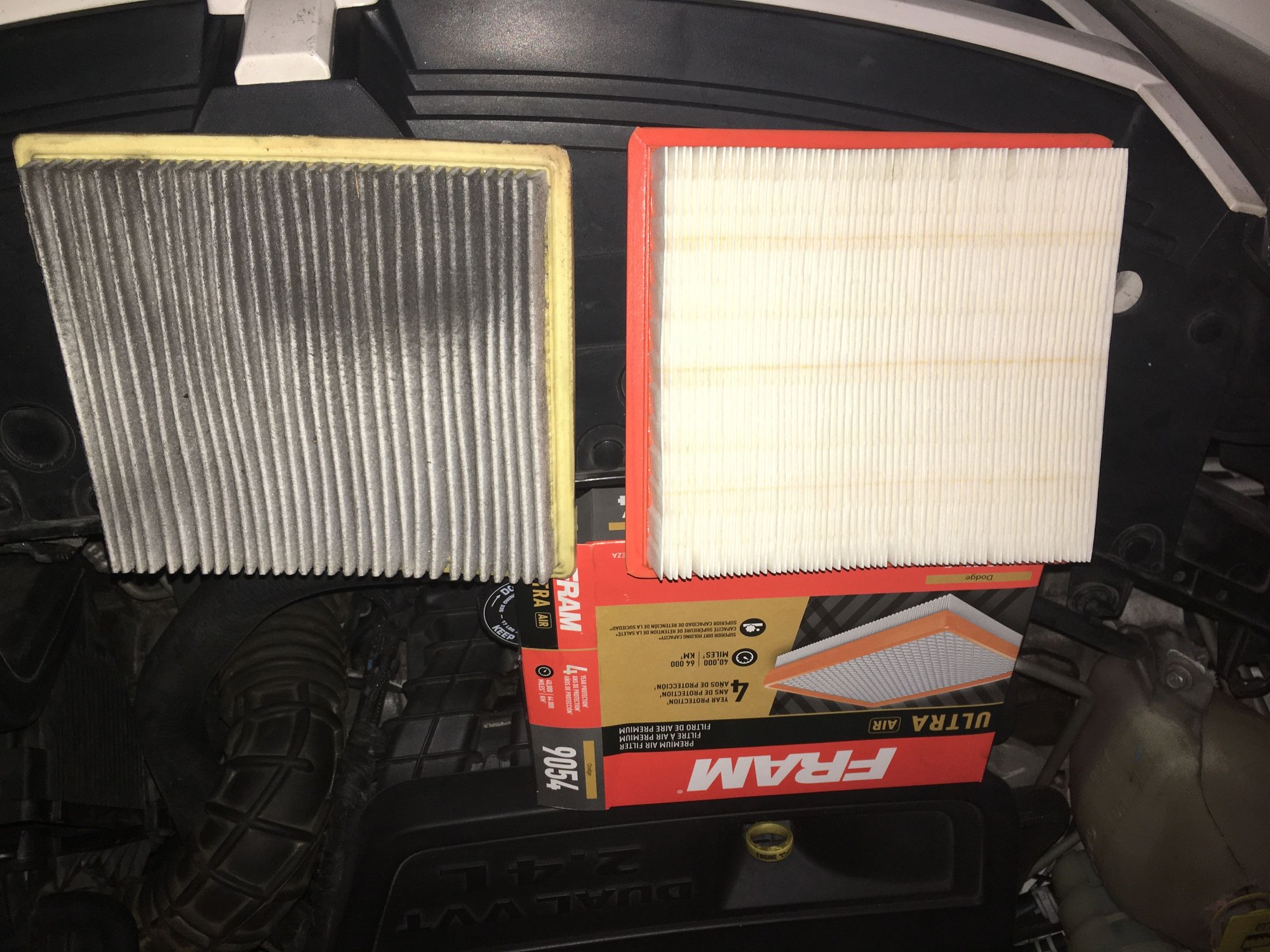

Oil change done!
Present Odometer reading: 105,520 original miles.
Previous Odometer reading: 98,085
7,435 Total Miles
What a difference a new Air Filter Makes!
Mopar all the way, baby!
Using the same Oil since the car was new!
