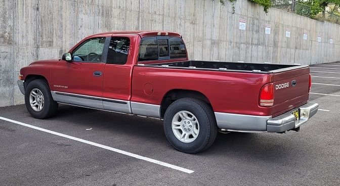

This isn't exactly what I originally asked about, but it's close. I "upgraded" to the 16-inch rims (from a 2003 model) and put 265/70R-16 tires on it. They have a diameter of 30.6 inches and they fit great with no lift kit and absolutely no rubbing.
This is a 100% stock 1998 Dakota SLT 2WD. Stock tires were 235/75R-15 (28.9 inches diameter). They look SOOOO much nicer than the stock '98 ones, IMO.
My speedometer is ~6% low, however.

More pics:

A decent tire store should be able to correct your speedometer for you. On yours, it's plug in the scan tool, press a few buttons, and you are done. Call around, see what they have to say.
Old Jun 24, 2022 | 04:56 PM
Ninety8_V6_2WD's Avatar
Ninety8_V6_2WD
Joined: Jul 2018
Posts: 5
Thanks for the suggestion. I hadn't even thought of that.
