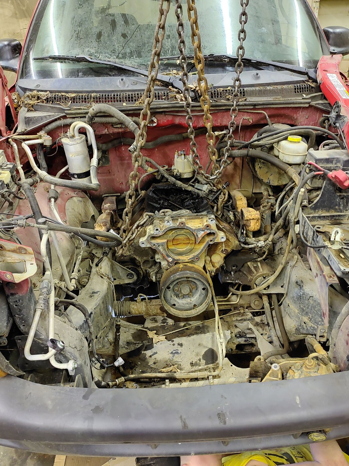

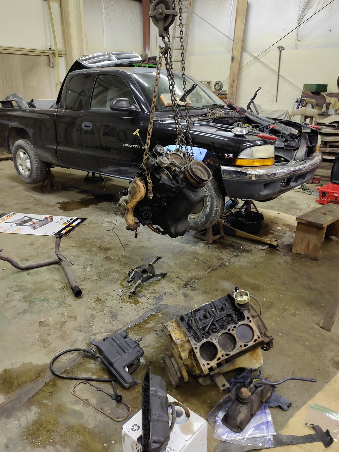

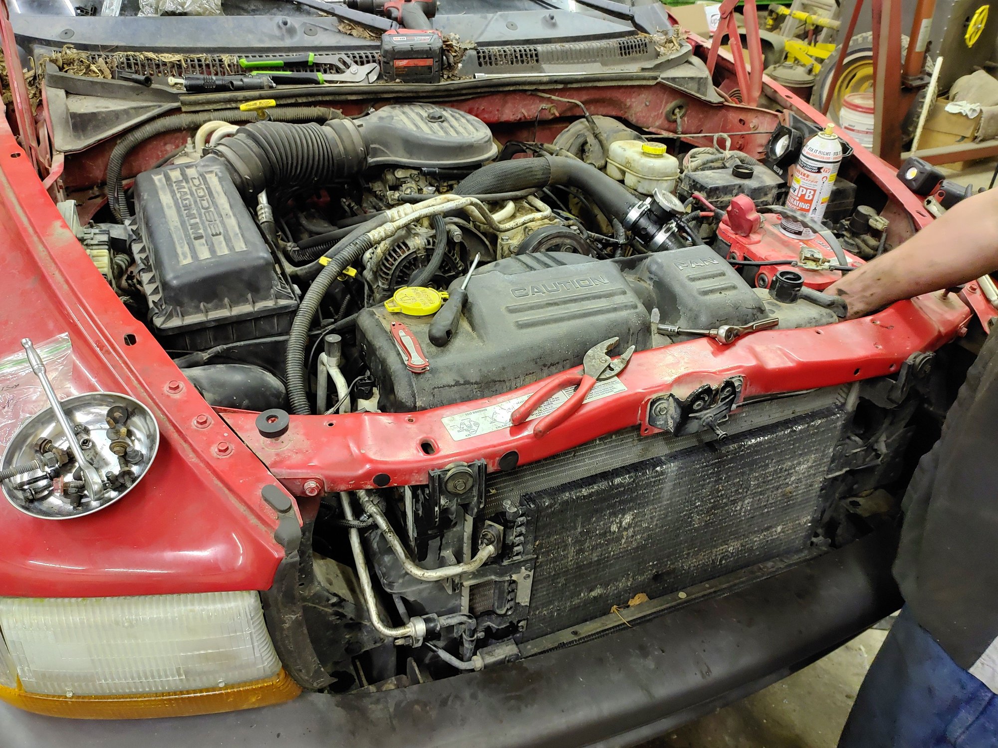

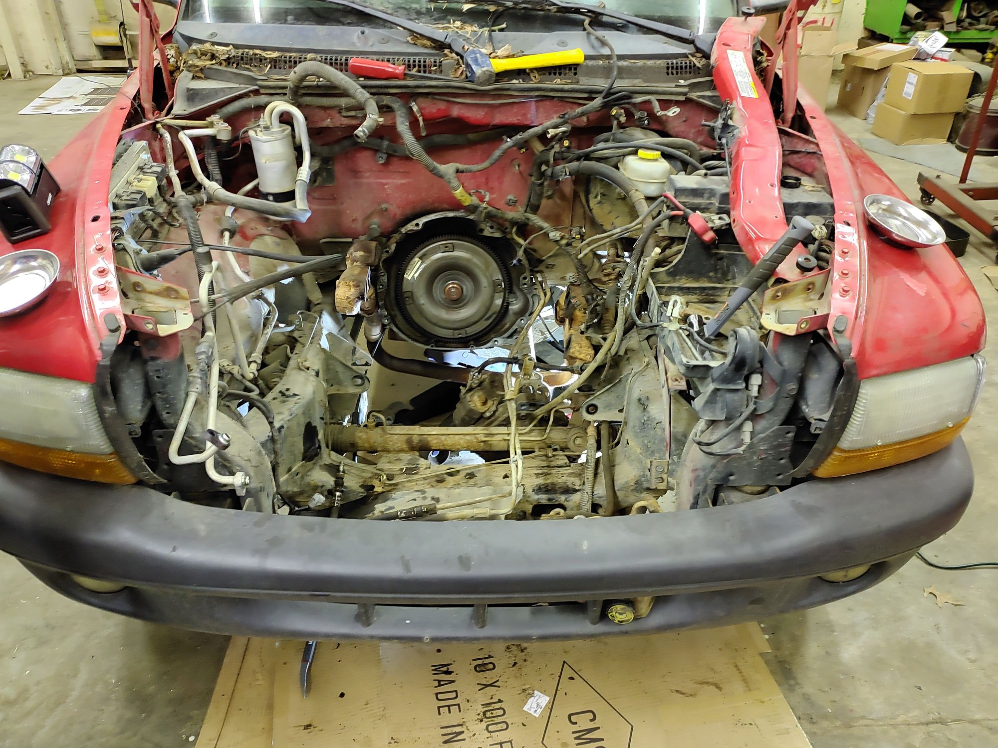

Quick update. Worked the past 3 nights and got both engines pulled. the 97 (that ran) is NASTY. Tons of buildup, sludge, etc. I should've taken a few pics, but it was close to 1am when we got it out, so yeah.
Now it's the process of getting the engine cleaned up as much as possible. I got a handful of products to help. We put a motor flush in the engine and ran it a bit before we pulled it in to take it out. It appears to have helped some, but the buildup is significant (are hard like a cracking, dry, rust feeling in many spots). I also got some Lucas Oil stabilizer and Marvel Mystery oil. Those are going to be saved for down the road, after a manual deep clean.
QUESTION: What should I use to help break down the buildup in the valves/heads? That's where is by far the worst. Can I use Gunk Engine Degreaser? It looks like a good product, but I've only seen it use for general engine bay cleaning, not necessarily after someone removes the valve covers.
Thanks in advance!
03 after engine pulled
03 blown engine pull
03 blown engine with milky oil etc draining
97 engine pulled
97
