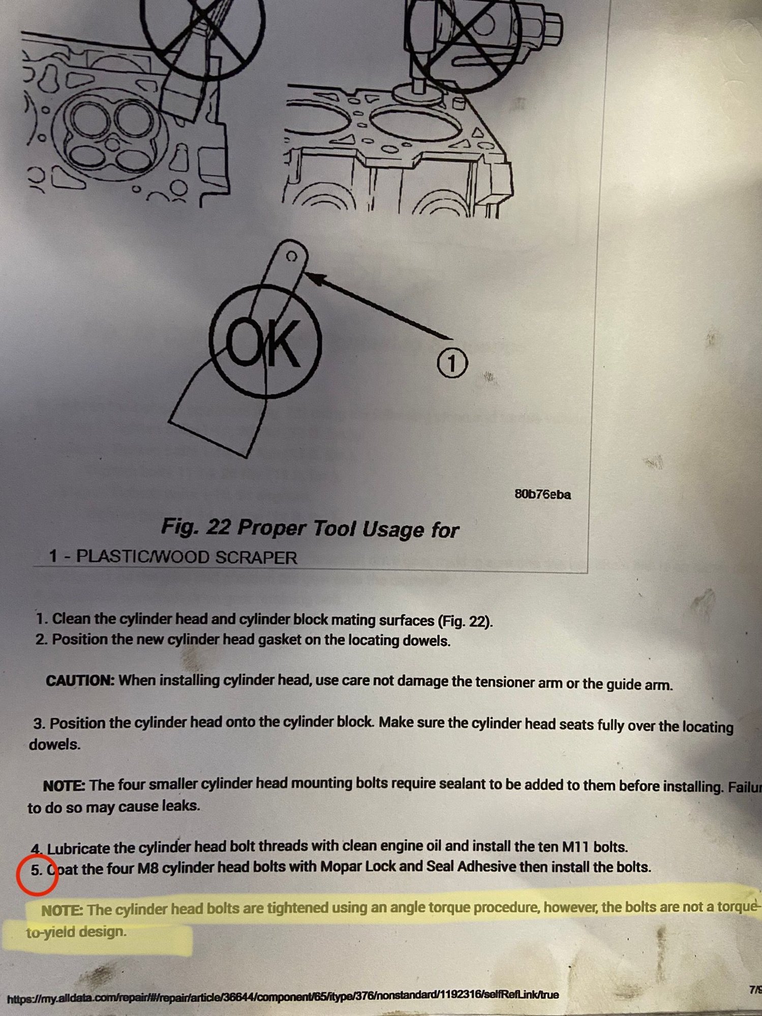

Service manual states they are not TTY head bolts and on previous page give inspection instructions to preform on the bolts for threads and stretch. The bolts I removed passed and I kept them in orientation. I got the thread lock and sealant for the M8 head bolts. The M8’s I removed did not have the thread lock sealant. So it appears these bolts have been replaced and are not the factory mentioned non TTY, to add to my dilemma.

Posts: 87,475
When in doubt, replace them.
Generally though, if bolts ARE TTY, the service manual will flatly state that, and tell you to install new ones.
