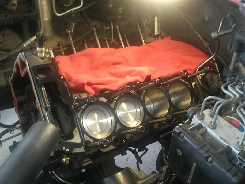

Sure wish these pics were still working..
I gotta tear off into my 4.7L project - i got a leaking head gasket or crack in head idk which yet..... and i gotta do timing chain eekekkk!!!

I have rebuilt two 4.7's. First of all, if someone brags about their 4 bolt Chevy, you laugh in their face because your engine has 27 bolt mains. Also, strange enough, they both had spun bearings.

Originally Posted by Shawncv1987
That "main timing sprocket" is the idler sprocket and if your planing on re-using the engine your going to have to replace the main tensioner you broke and the timing chain guides I just did my 4.7 cost around $500 in parts with new timing chains and all gaskets ands seals took about 6 hrs you have to get both cams and crank at TDC align the chains properly on idler and crank sprocket slide it all in place without moving chains then remove cam sprockets w/out moving cams to put the chains on them aligning the dots then reinstall sprockets on cams again w/out moving cams from TDC then hand turn the crank w/wrench 2 full engine rotation and check that all sprockets are back at TDC and that's just to set the timing! It's not a job that just anyone should take on especially someone that don't even know what the parts they are removing are called!
As I said, I've rebuilt two of the 4.7s. Those timing chains will help you learn new curse words! Make sure the intake is torqued down properly. When my cousin started his up, it sounded like the pump in the transmission was going implode. It wasn't just a vaccum noise, it sounded more like a Pneumatic Die Grinder. Once the bolts were loose, and torqued down in the proper order, all was well!

Make sure you get NEW chain guides. The plastic of the guide will usually shatter when trying to get tension off.
