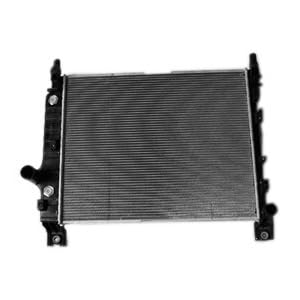

"><img src=" /> ">
See larger image and other views See larger image and other views
Quantity:
TYC TYC
TYC 2294 Dodge Dakota 2-Row Plastic Aluminum Replacement Radiator
List Price: $258.30 Price: $116.10 & this item ships for FREE with Super Saver Shipping.
Details Details
You Save: $142.20 (55%)
Found this on Amazon it is a 2row
In Stock.
Ships from and sold by Amazon.com.
