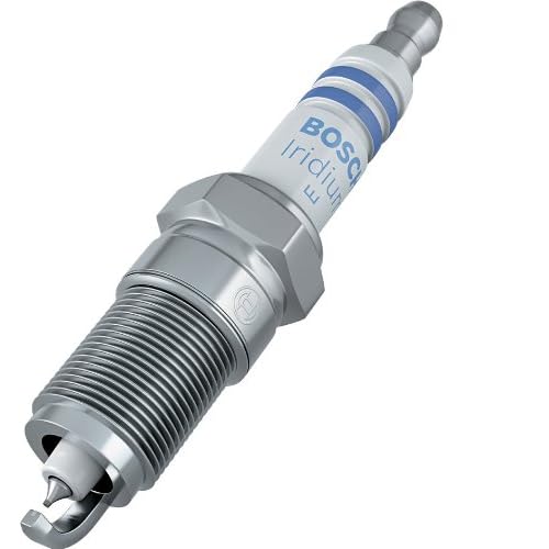

I only learned this last year reserching sparkplugs and Hot coils for my 2.5 engine the Accel and the MSD coils are the same product just one is red the other is yellow im sure they are made by the same company then branded to each.
The Bosch Iridium Fine Wire Spark Plugs only run about $6 each I think I got them for less than that.
Sparkplugs can be such beautiful looking fine machined things
