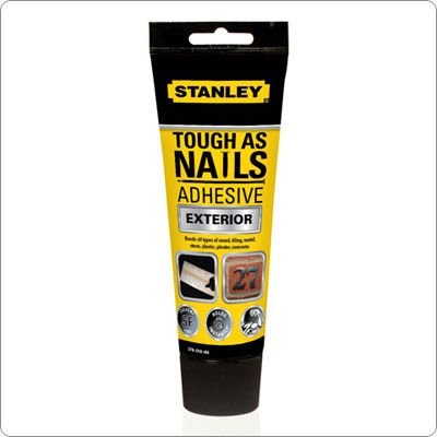

If you have the space to do it
If not try this just glue the shoe material back on I'm sure some kind of glue would work its just the parking brake not much force or heat on it at all so glue should work.
Just clean up everything and turn the surface of the drum/rotor adjust it and done
Tough as Nails I think would work great its good stuff
