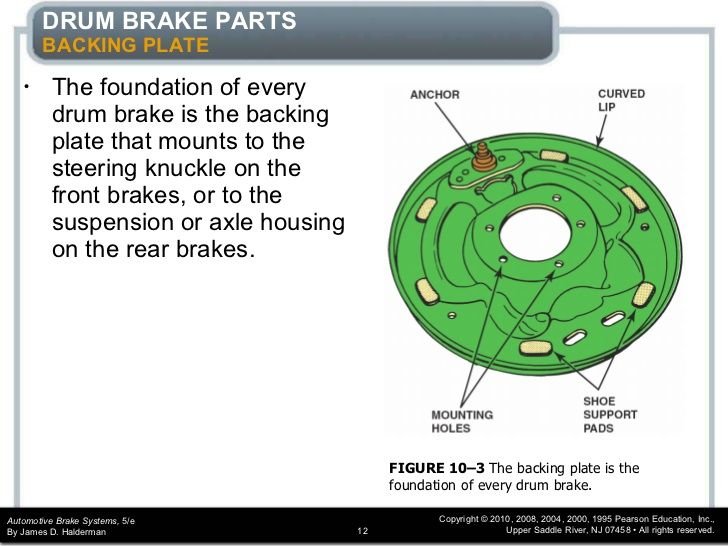

You could have a bent backing plate or a worn backing plate some times the backing plate gets grooves were the shoes mount to the backing plate.
Only way to tell is pull the shoes off and inspect the backing plate if you have backing plate wear grooves this can cause the shoes to stick at times.
Called shoe support pads also
