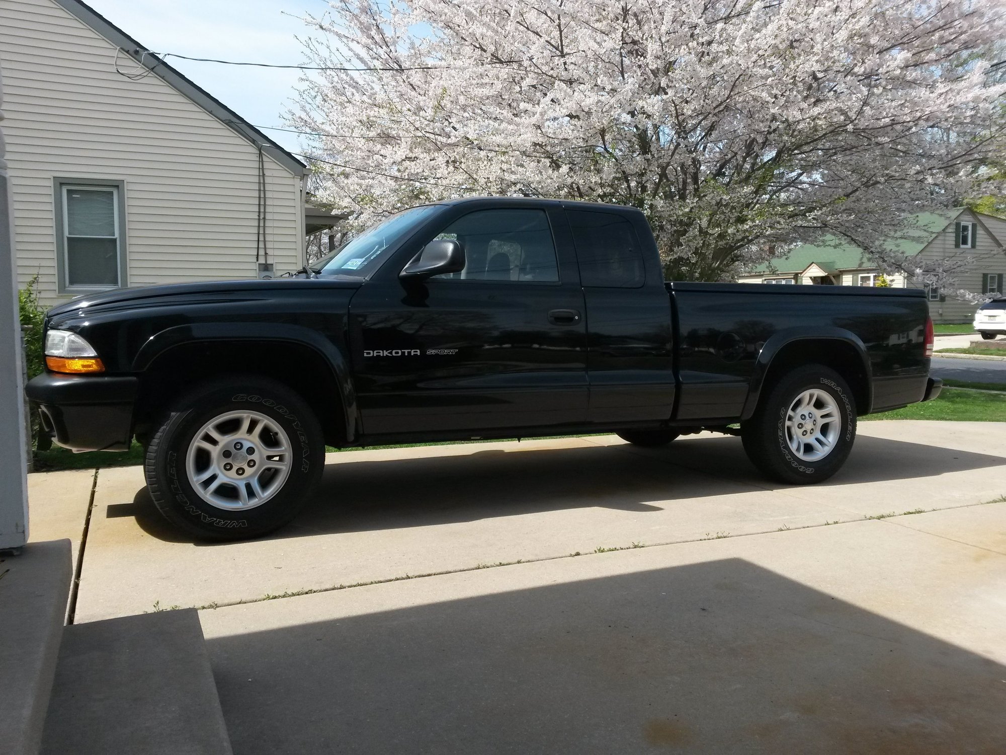

Interesting. The factory springs had 7 coils, the canucks had 7 as well. The quad cab springs have 9 and just slightly taller. Im not a coil spring expert, but ride quality is firm, but smooth and controlled. Couldn't be happier with my experimental leveling "kit".
My truck is a street queen as well, no offroading or bigger tires.

Old Apr 19, 2015 | 11:27 PM
JDak02's Avatar
JDak02
Joined: Dec 2014
Posts: 40

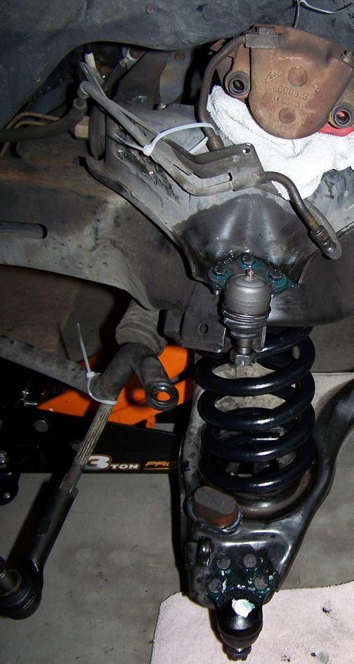

Old Apr 19, 2015 | 11:31 PM
98DAKAZ's Avatar
98DAKAZ
Joined: Jul 2011
Posts: 4,895
Likes: 35
From: Gilbert, Arizona
I have a Pic or 2
0
Old Apr 19, 2015 | 11:38 PM
JDak02's Avatar
JDak02
Joined: Dec 2014
Posts: 40
Looks like those ones you put in are atleast 3/4" shorter from what I can tell. When removing your old springs, did u use a compressor? I didn't. I read several places that it wasnt needed. Maybe its risky, but I had no problem at all.
Old Apr 20, 2015 | 12:10 AM
98DAKAZ's Avatar
98DAKAZ
Joined: Jul 2011
Posts: 4,895
Likes: 35
No 1/2 an inch is all yea I just jacked the truck up I tried a spring compressor at first but it scared me it kept popping off with a loud snap every time. Jacking was way easier and safer except the last part.
If I remember they were Moog or Rockwell springs from O'reilly auto parts back in 2011.
