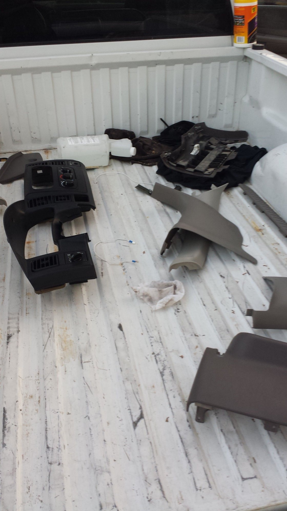

Not sure on how to replace the bulb in the A/C control unit itself, but getting to it isn't that hard, I believe its 2 power plugs that attach to it, but to get to it
Remove the torx 2 or 3-4 screws (t10,t15 maybe) on bottom of leg bolster/panel whatever its called
One above OBD Sensor and above driver kickpanel 1 or more to the right
Be mindful of brake release rod, if fact before you begin, pull the out lever all the way, look for silver rod just swing the plastic clip Down slides and swings down, pull rod towards you
Then two Philips screw above steering column, on top of the guages
Once thats done move the wheel down, apply parking brake, if you have an auto move the shifter all the way to first
Starting near the headlight switch pull the front face off, Dissconnect the headlight switch, ninja twerk the dash out.
Disconnect the 4x4 switch if you have one
Ugh dust...
What the whole piece looks like when removed
