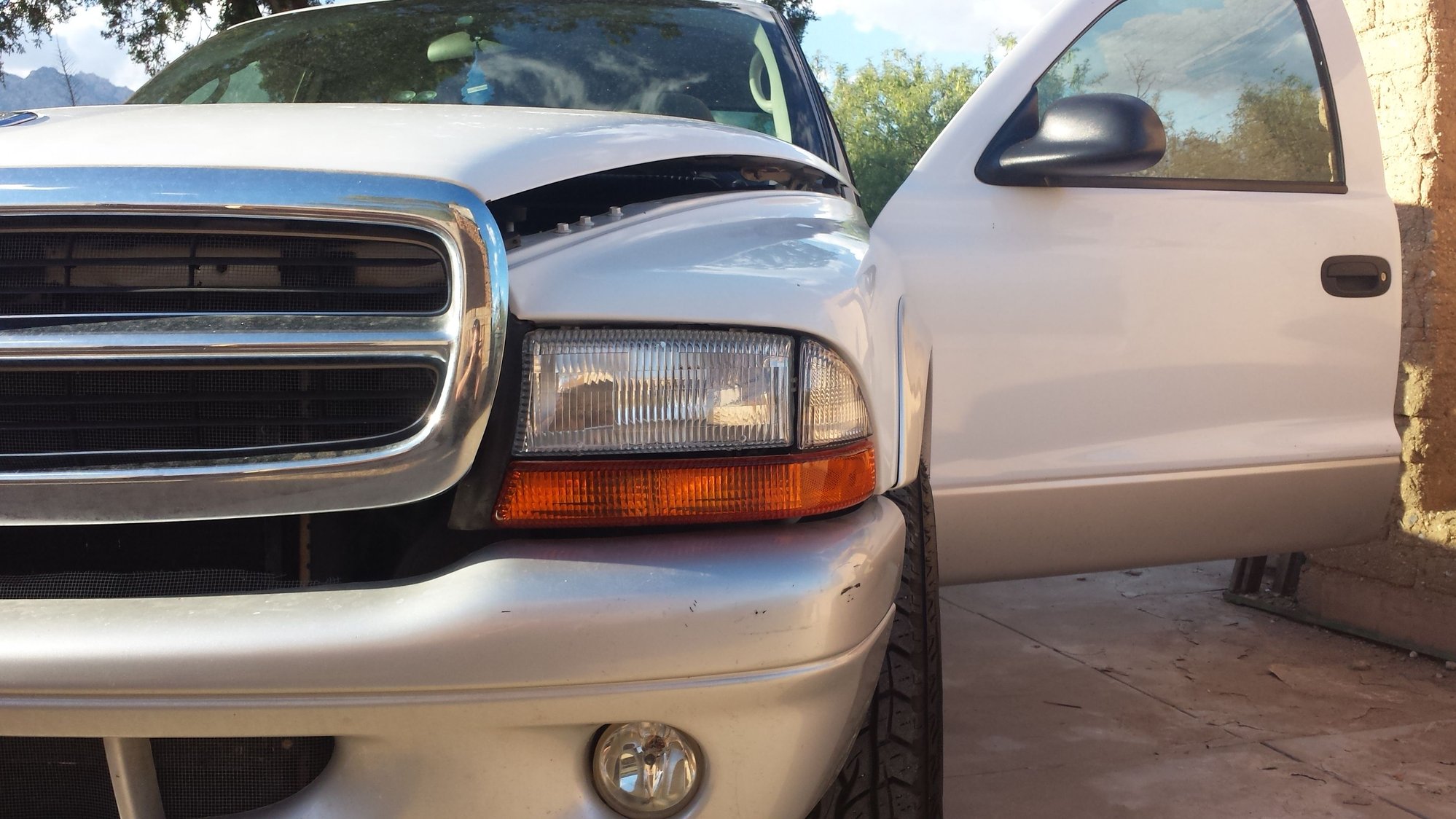

Before Removal and refinish
Look at that lovely Haze.

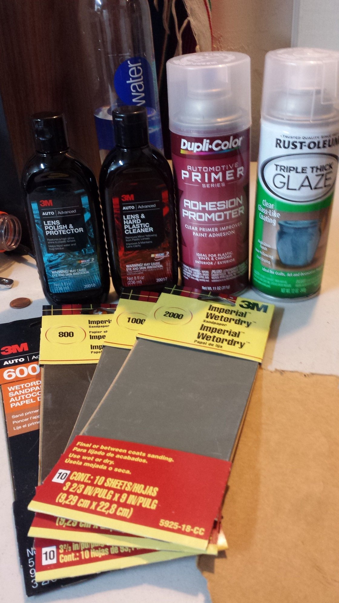

So with reckless abandon I bought
600, 800, 1000 and 2000 grit sandpaper, sadly Home Depot didnt have 600 grit (WTF?) so I had go to O' Irish auto parts and get 600. Which was the same price as Home Depots but only had 5 sheets vs 10 from the ones at Home Depot.
3M Lens and hard Plastic Cleaner and a bottle of Lens Polish (I used this for the Parking light/ side marker)
1 can of clear gloss coat.
Also not avalible at Home depot is Adhesion promoter.
Not wanting to let the Drill feel lonely I opted to remove the lights vs doing it still mounted
So starting with a 5 gallon bucket of soapy water i cut my sandpaper into squares and let them soak for a few minutes. Im no expert at sanding so i went and wet sanded with all the grits.

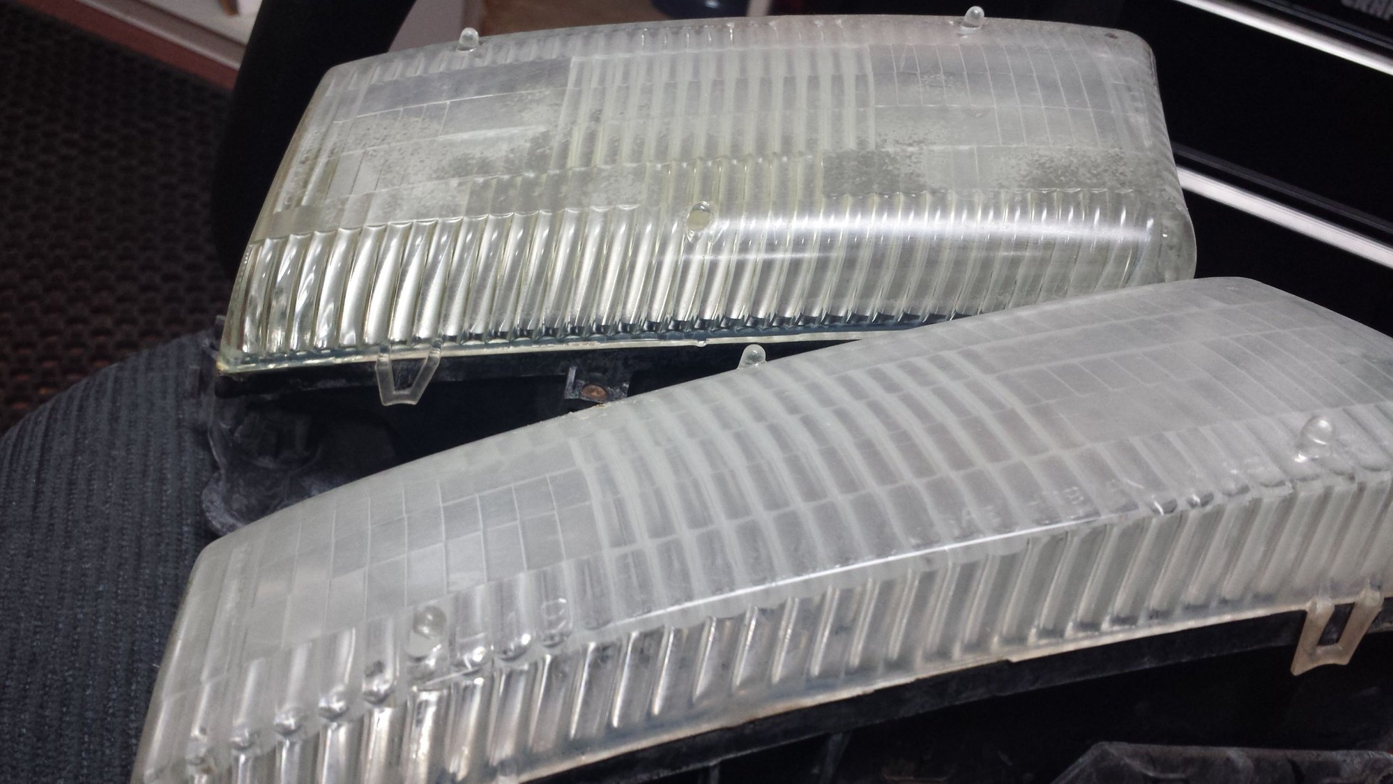

I spent a good 30 minutes hand sanding with the 600grit on each headlight
Thats after the 600/800 Grit sanding
And after 1000/2000Grit
Now at this point im more excited than a 5 year old boy at Hooters, My arm feels like it too!
I now used a terry cloth and the 3m Lens/Plastic Cleaner as the last scrub stage, And wow what a difference

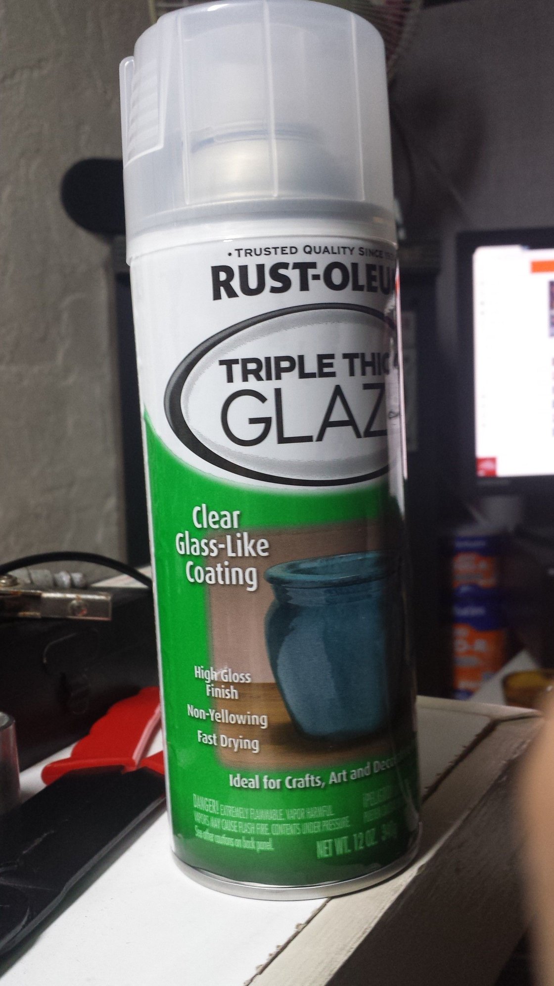

After this I clear coated them, I didnt use the Lens polish because of this, Now only time will tell how this goes/last
Sadly i didnt take pictures of the spraying Adhesion promoter and clear coat.

Well everyone i talked to said the clear coat would protect the the lens (somehow i don't believe that, still testing lol) but would yellow in a few weeks, only reason i got this particular clear coat was 1. it said non yellowing and 2. it was the only decent product from home of dur-pot
But like i said only time will tell. Im hoping for at least a year. Im still hoping for covered parking but alas nada.
