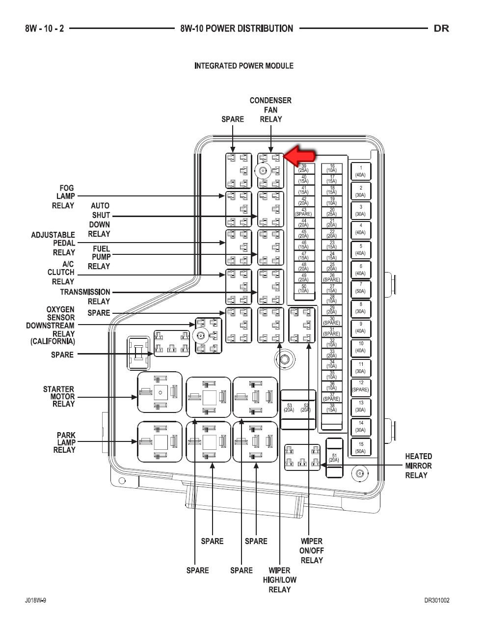

Is this the relay you checked?
from the 2003 service manual

No, mine is apparently a 2002 according to the sticker in the drivers side door, but, is a 2003 on the title, dunno why, ain't gonna worry about it now, LOL. Anyway, the relay is next to the ASD relay closest to the fender and to the cowl, I don't know how to post a pic of it. I swapped the ASD relay for the cooling fan relay, no change.
