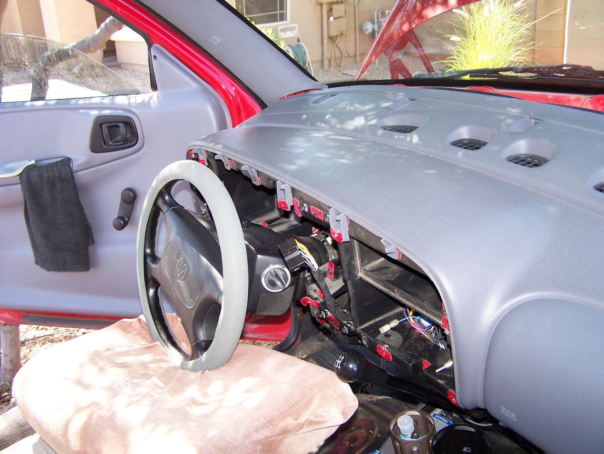

I have a very bad back and cant well shouldn't take long trips but this works for me.
I purchased a medium quality memory foam pillow the ones that have the neck bump/hump and sit on it every drive high hump side toward my back and works great. I think the hump works best on the butt not the legs that would put too much pressure on the legs. I have been using it for as long as I have had my 98 Dakota and its still in decent shape I just pull the cover off and wash it when needed here is a tip dye the cover black or dark brown or it will get ugly stained ASAP.
I do have a bench seat not buckets so I'm not sure if that would work for buckets the pillow I purchased looks like the Pic and was a cheaper model around $35 I think not the $100 high end ones just be sure its not so cheap a model that if you sit on it it collapses down to a pancake their is veering degrees of quality some are very soft and not usable for anything but the high end expensive ones are almost too stiff for a butt cushion.
When old and damaged you make do as you can to feel comfortable and keep going it sucks but its life deal with it.
When People see the pillow they kind of look at you like what's that but F-K them without the pillow my back would kill me driving.
One more thing see the pic that's almost an exact pic of the one I have see how thick it is I don't think the thinner ones would work as well.

A Pic of the pillow when I was removing my Dash that Brown thing.
