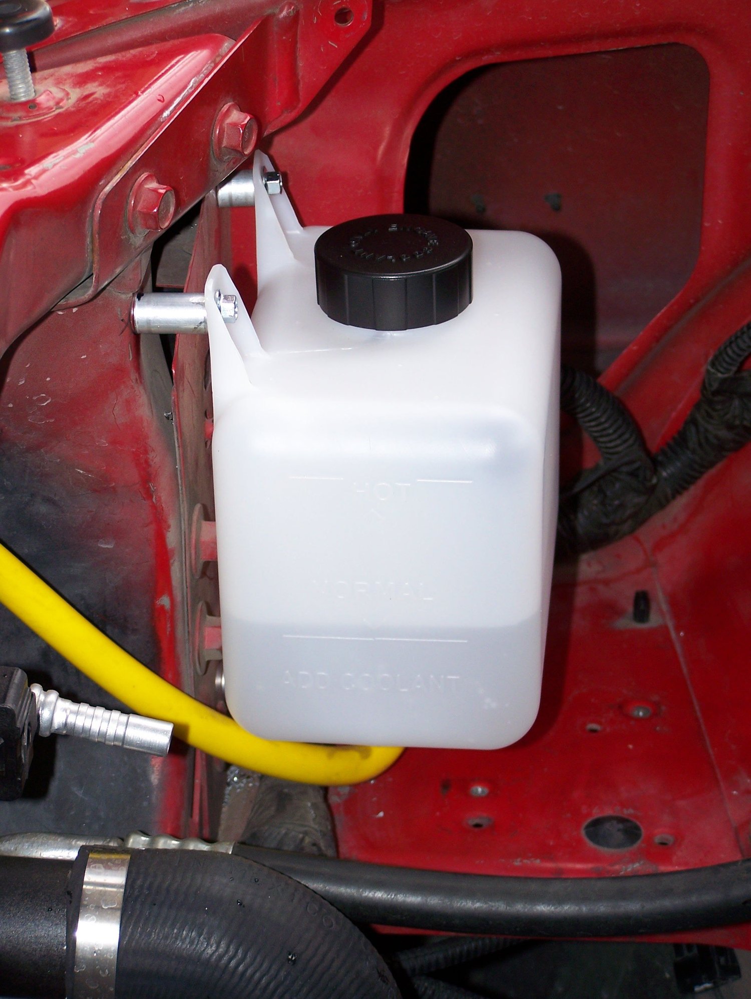

Something to look into is maybe the overflow tank has a crack in it fill it up let sit a day if you can then check to see if it dropped any.
After my conversion I noticed every time I pull the rad cap its never full to the top like my old rad setup I think thats just how it works with the 2000 and up rad setups as I never lose any coolant but the overflow tank level fluctuates. I have noticed the overflow tank sometimes overflows with a small lose I see the coolant on top of my custom tank cap it has a breather hole easy to notice. Why that happens I'm not sure probably need a larger tank my guess thats the only after market tank that would fit my location?
