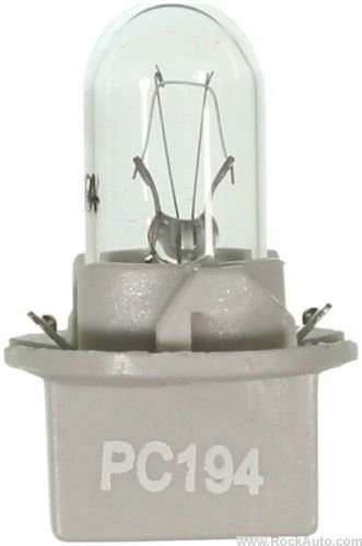

The bulbs that light up the buttons on the overhead console (reset home link etc) they also are the back lighting for other stuff inside. Where can I get them or does anyone have a part number. Here is a pic

rockauto under Electrical-Bulb & Socket / Instrument Panel Light Bulb
The bulb should pull out of the plastic base its a push in two wire
Miniature Lamp 35 cents plus shipping

The Amazon ones may be it.
The RockAuto are 194 based as way to big.
I'm thinking it's going to be a dealer only item too.
