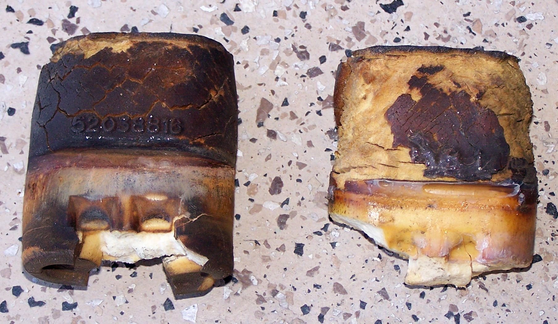

I just installed my new front control arm bumpers 2WD FINALLY easy to do just pry out the old lube up the new ones then pry them into place.
They were so rotten and crumbling up just BAD but at $20 each rockauto that sucks but dealer would be a little more.

Yea I have more fun coming up new Moog Stabilizer Bar Bushings and end link bushings now that its in the low 80's in AZ time to start working on the Dakota again.

They look like toasted marshmellows. Try biting into one. LOL

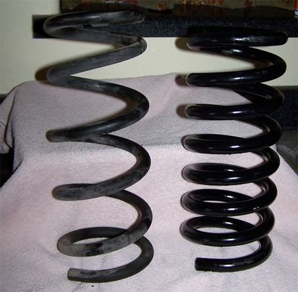

The new bumpers have helped give me not so jarring ride also as the new front springs I installed a few years back actually lowered my front suspension about one inch and has caused my front suspension to bottom out on the bumpers at times. The springs are stiffer than the stock springs but one inch lower this was not by my decision I ordered them as direct replacements but they came a little shorter with two more turns. I did want stiffer springs just not shorter or lowering springs the stock springs had gone soft on me so I replaced them.
