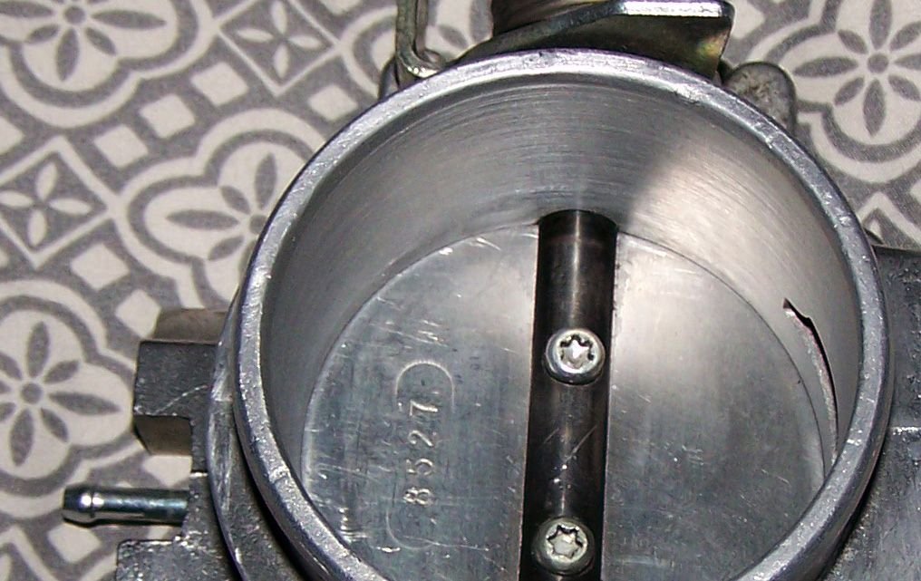

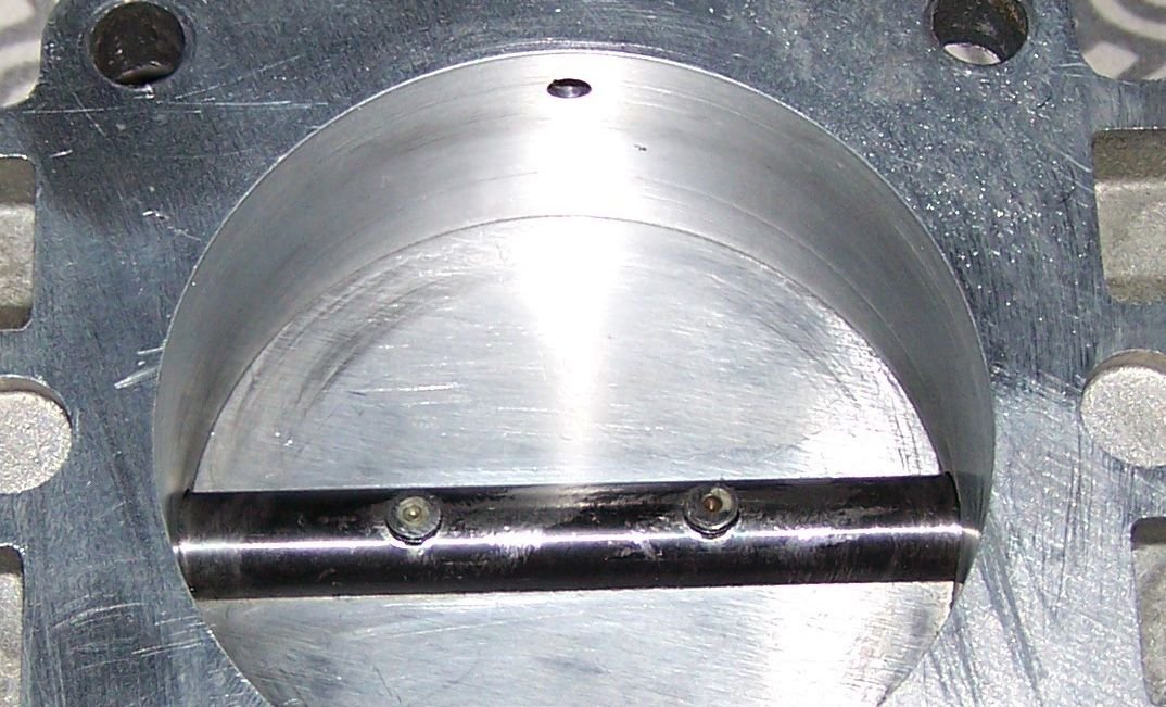

OK an update
60mm throttle body is in and I must say it has made a difference with acceleration I have more guts to the 2.5 now the 2.5 breaths better.
I truly wasn't sure it would help but it has helped just be sure the manifold is opened up as a stock manifold is only about a 50mm opening so if you don't open it up a 60mm TB doesn't work at all.
Most big throttle bodies on the market for the 2.5 will be a 62mm so the manifold will need to be opened up to a 62mm.
I had a custom TB made for me I think a 62mm is not needed or makes a difference on the 2.5.

I modified my intake manifold considerably but the outside I had media blasted but that leaves it a dull gray color I used a crimped end brush on it to polish it up and a small hand wire brush.
Just beware getting the best from the 2.5 is expensive most like to swap them out for a V8 as its way cheaper to do so. You need to be able to make these changes DIY as a shop will charge you a boat load of cash.
The cost to getting more from the 2.5 is very high as the results are minimal to the cash spent.
A larger throttle body gives you the best results for the cash spent. So remove the intake manifold have it bored out to a 62mm then install a 62mm throttle body. You can find cheap intake manifolds on ebay around $40 and up but most are super dirty.
Thats a good way to go get a used manifold take your time cleaning it up then modify the manifold like I did and move the air temp sensor into the air hat this gives you better air flow a 62mm TB and things are good just remember you need the idle chamber, iac and map sensor off the 2.5 for it to run and idle proper.

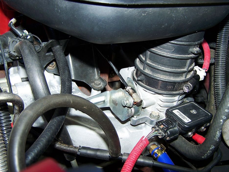

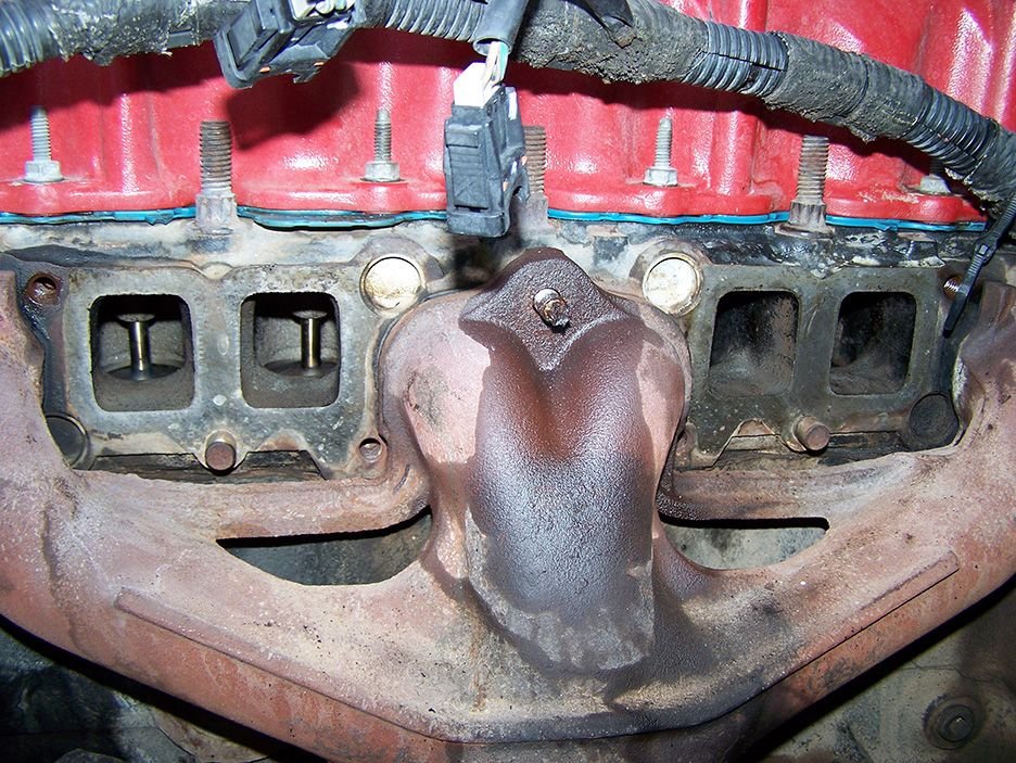

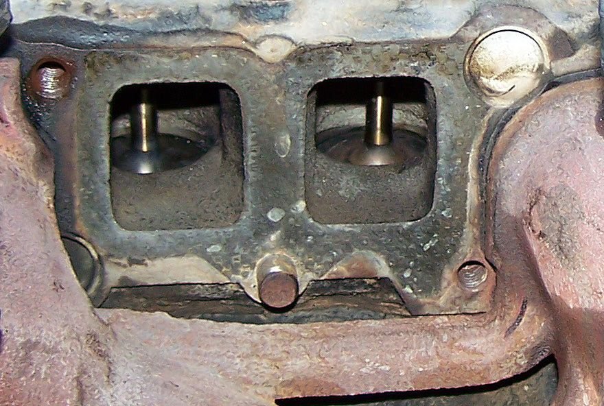

A few other Pic's I didn't post These intakes look clean but they were extreamly dirty before so take note.

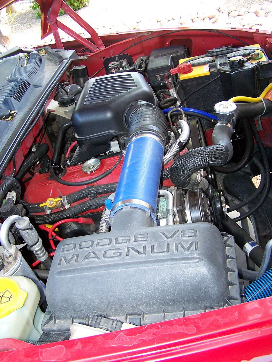

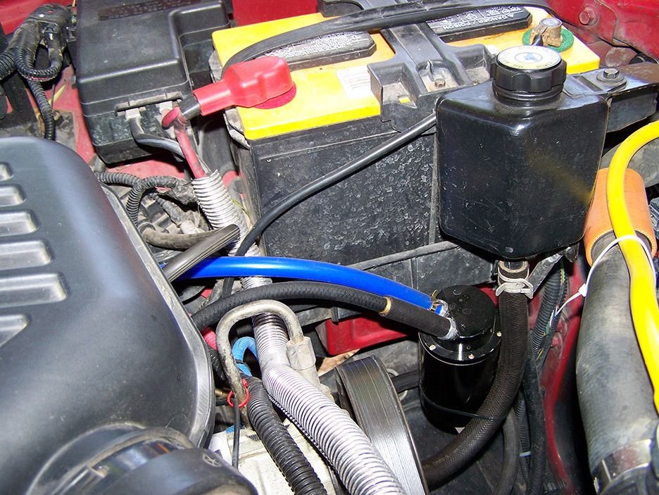

These are my most up to date engine bay Pic's my last were a year ago

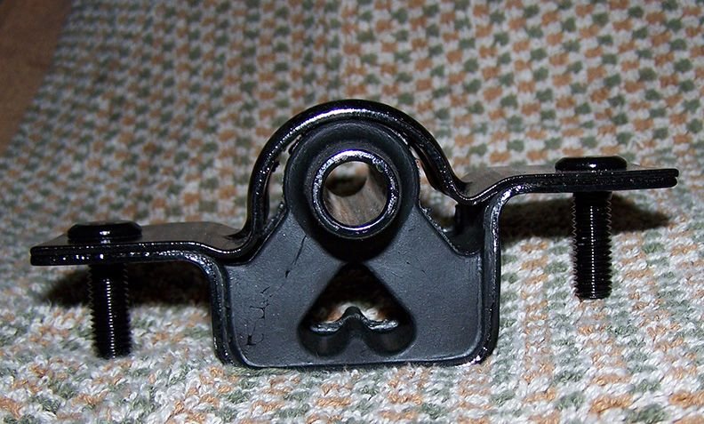

My rear trans mount has crushed down in the Pic of the new one you see an upside down heart on the bottom when I looked at my original mount that heart shaped open space is gone crushed down and on top their is a big gap were their should no gap the rubber is cracked up also.
I hope I don't need to drop the frame cross brace under it down that would suck. If I need any engine mounts and I may every time I look they are not available anymore sometimes I look and one is available but thats it.
