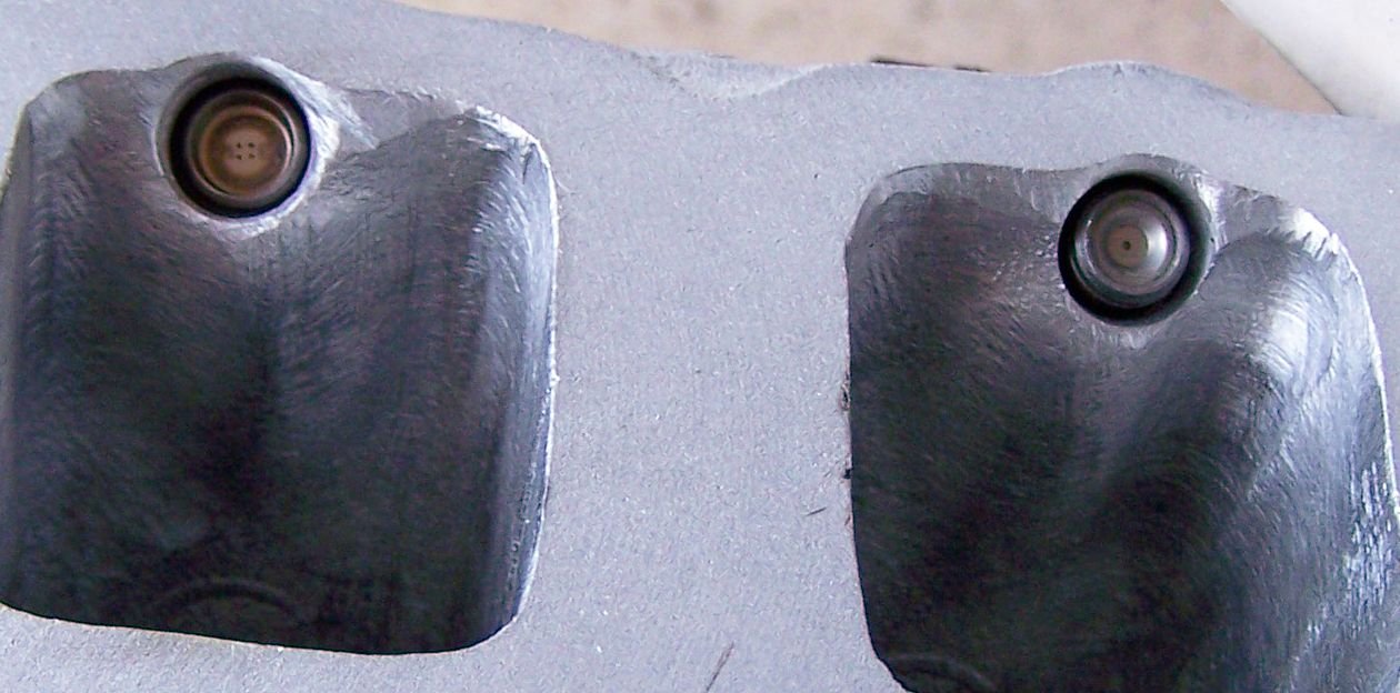

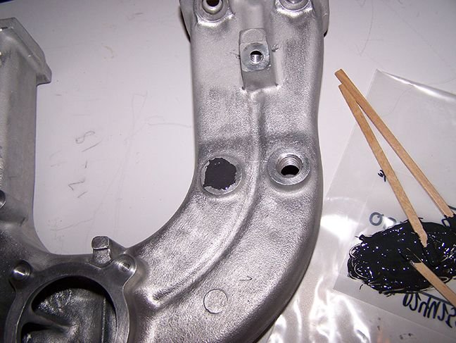

Im working on a few projects for my 2.5 Dakota lots of modifications going on.
Lots of new fun to have

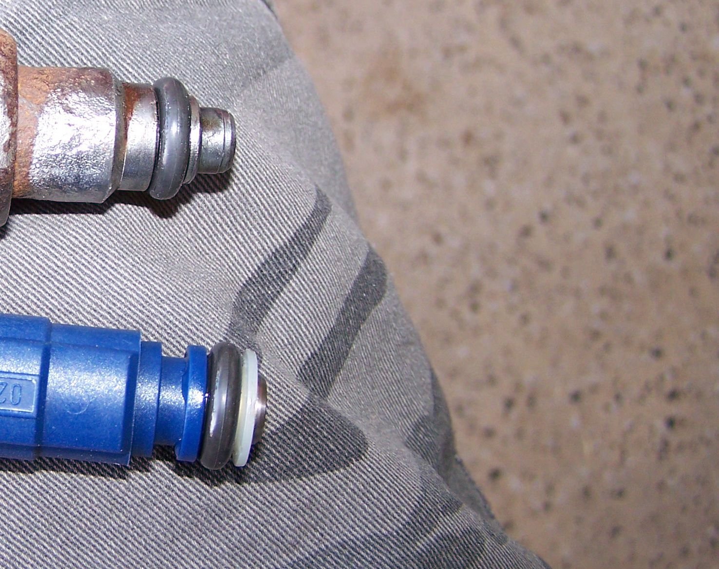

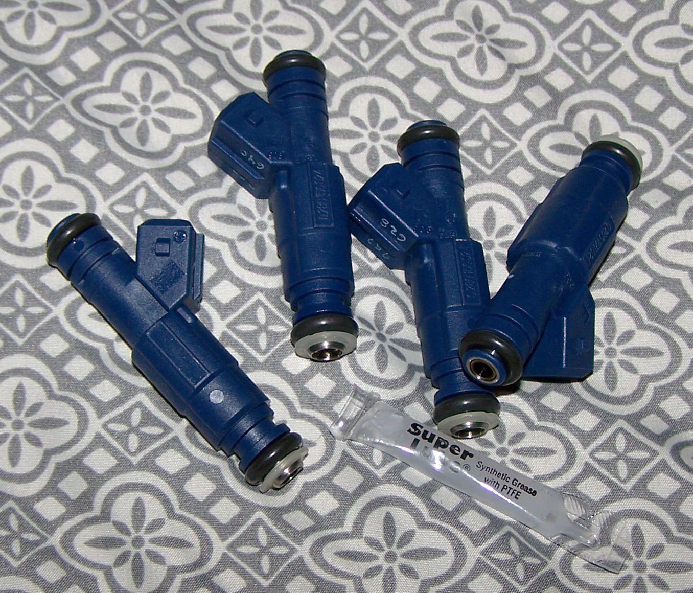

Main change is new fuel injectors single nozzle to 4 nozzle and modifications needed for it. Changing out my upper O2 sensor to an NTK removing the Bosch also replacing all exhaust bolts/studs and fasteners needed.
Adding some lighting and other small things

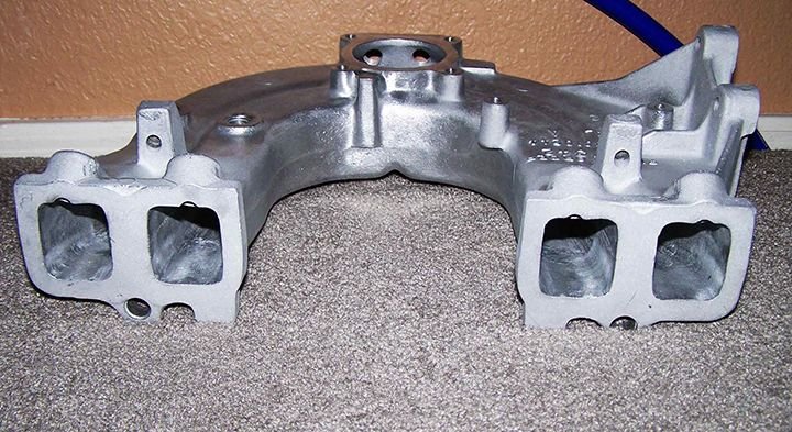

Not sure Im going to gain anything by the 4 hole injectors but Im trying it out Im using a second used intake manifold I purchased to do this with. An oil catch can will be inserted at a later date to stop the oil from getting sucked into the manifold.

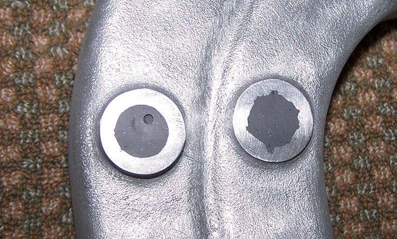

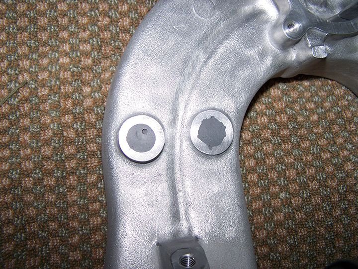

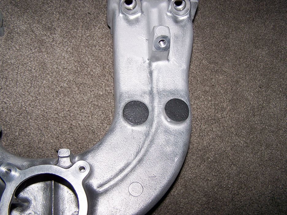

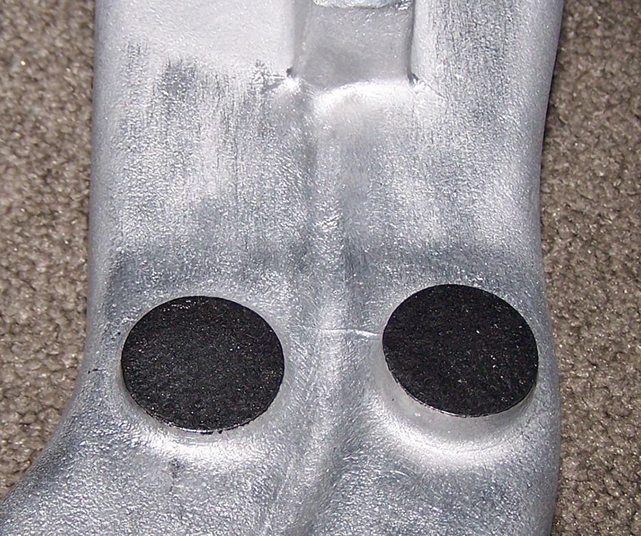

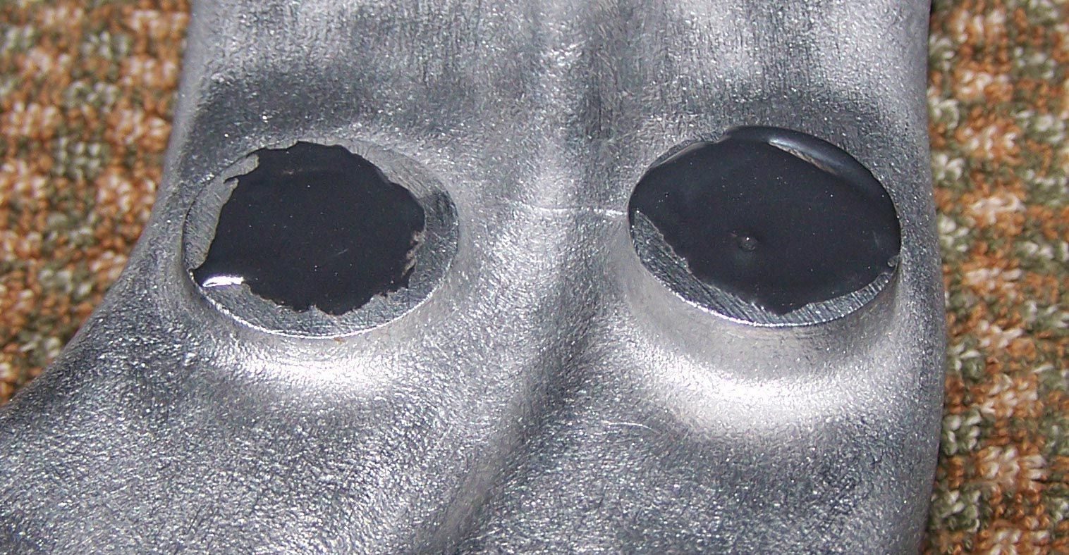

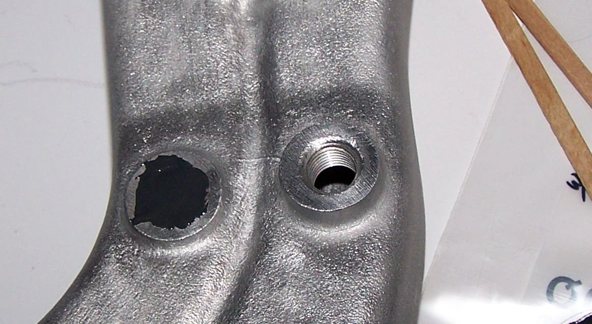

Finished filling in the unused vacuum and sensor ports had a small air bubble in the JB weld but its no problem.
The used intake manifold was a bit beat up with corrosion as it came from the rust belt but at $33 used it works just fine she shined up ok.

Lightbulb

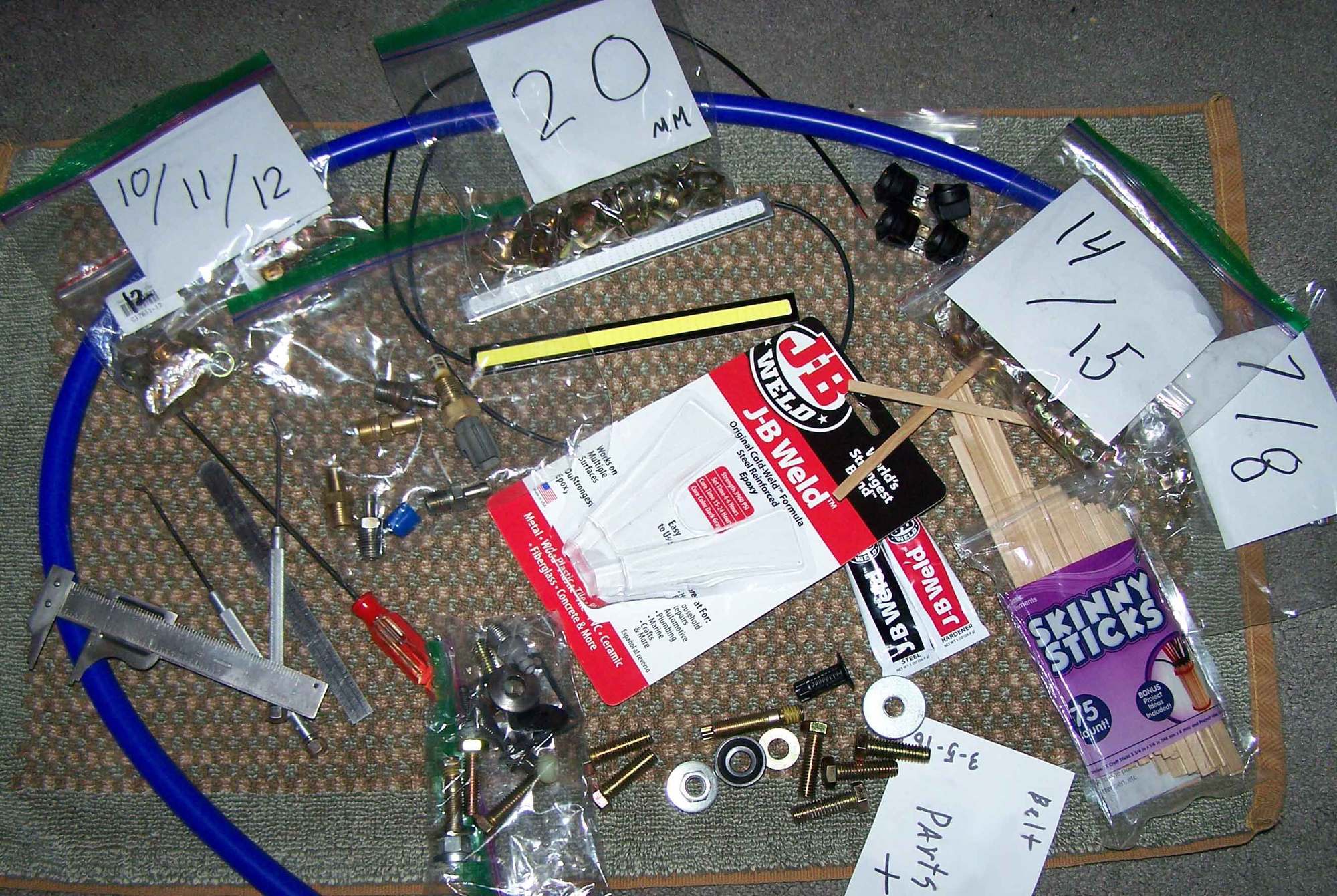

Oh by the way to stop the JB weld from sagging down into the manifold I stuffed it with plastic shopping bags worked great and the bags didn't stick to the JB weld pulled out easy.
Also those bags in the first Pic with numbers on them are spring hose clamps I grabbed a number of different sizes as I wasn't sure what sizes I may need for the vacuum hoses.

OK I didn't like the bubble hole and filled it in and painted the ports over.
Im installing everything in mid April still need a few things.

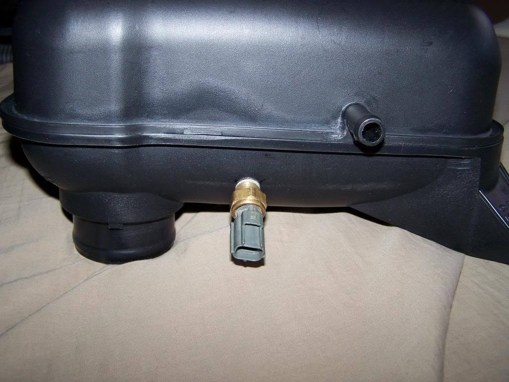

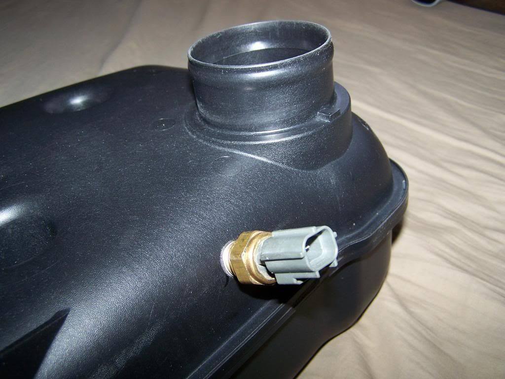

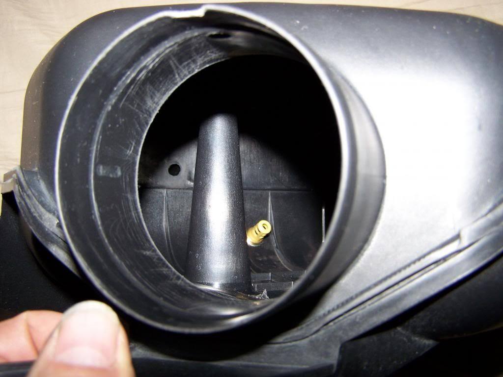

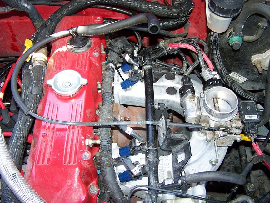

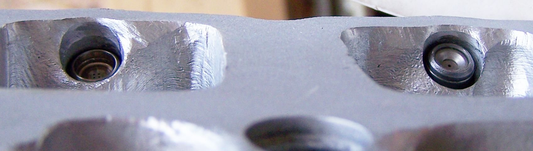

For those that may not know why I filled in the air temp sensor hole its because I installed it in the air hat.
Some Pic's for ya been that way about 2 years now everything runs great. I just wanted it out of the intake for the cylinder it was in so I get better air flow to it the sensor blocks it a small amount.
Every small amount helps the 2.5

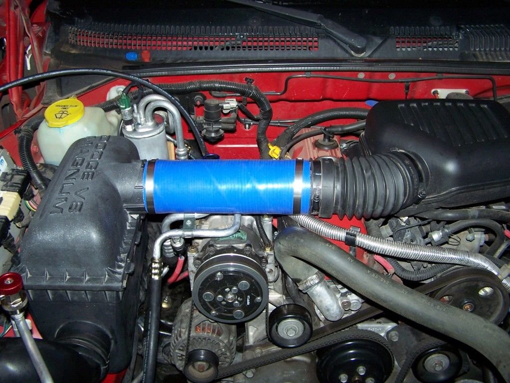

Grabbed a new intake pipe today also as my old one has faded and was blue always wanted a red one just couldn't find one 3 years ago.
$15 on ebay ( 4-PLY 3.25" ID 12" LONG STRAIGHT RED SILICONE HOSE TURBO/AIR INTAKE PIPE )

Well all new parts are in and buttoned up....... All's good
Let the PCM adjust for a few days and see if I improved things or not.

Well new 4 hole injectors are in everything runs good just waiting on my bored out throttle body to show up.
