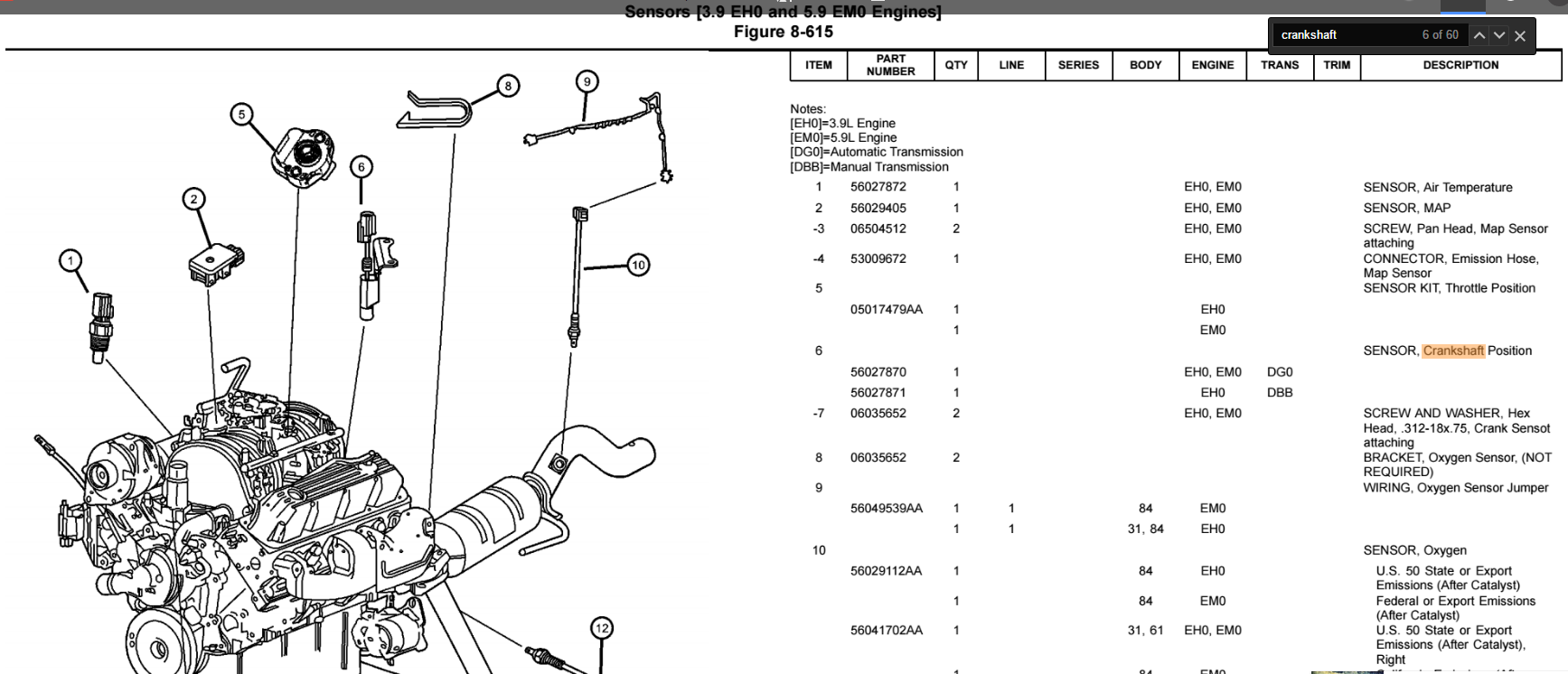

thank you for the welcome 00DakDan, really appreciate the input on the problems, i did figured the camshaft using a google image (which thank you for verifying is the one on the distributor) but for my life cant figure where the crank sensor is,this is my first time dealing with a car problem myself hence i thought was 3.7 not 3.9 lol. So im guessing the best approach would be replacing the 3 sensors and the thermostat ??
im guessing this is the image i should be following correct?

Yes that's the crank position sensor CKP.
