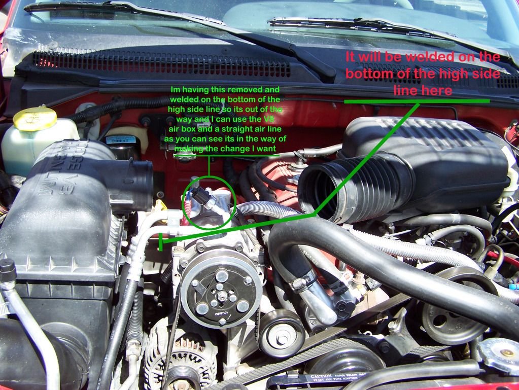

About 6 inches out of the compressor on the high side line the low side sensor is plugged into the receiver dryer canister on the firewall of the cab.
Both of these rarely go bad

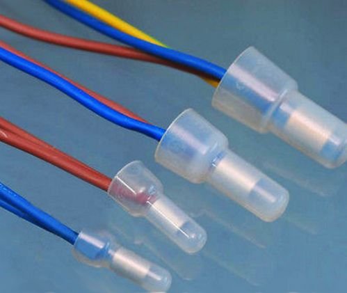

My wire to activate the A/C clutch went bad and became intermittent I just cut off the connector and crimped the wires together with a short extension wire added in as cutting the connector off made the wires too short that connector sucked anyway.
I used these simple easy and cheap a new dealer only connector runs around $20.
