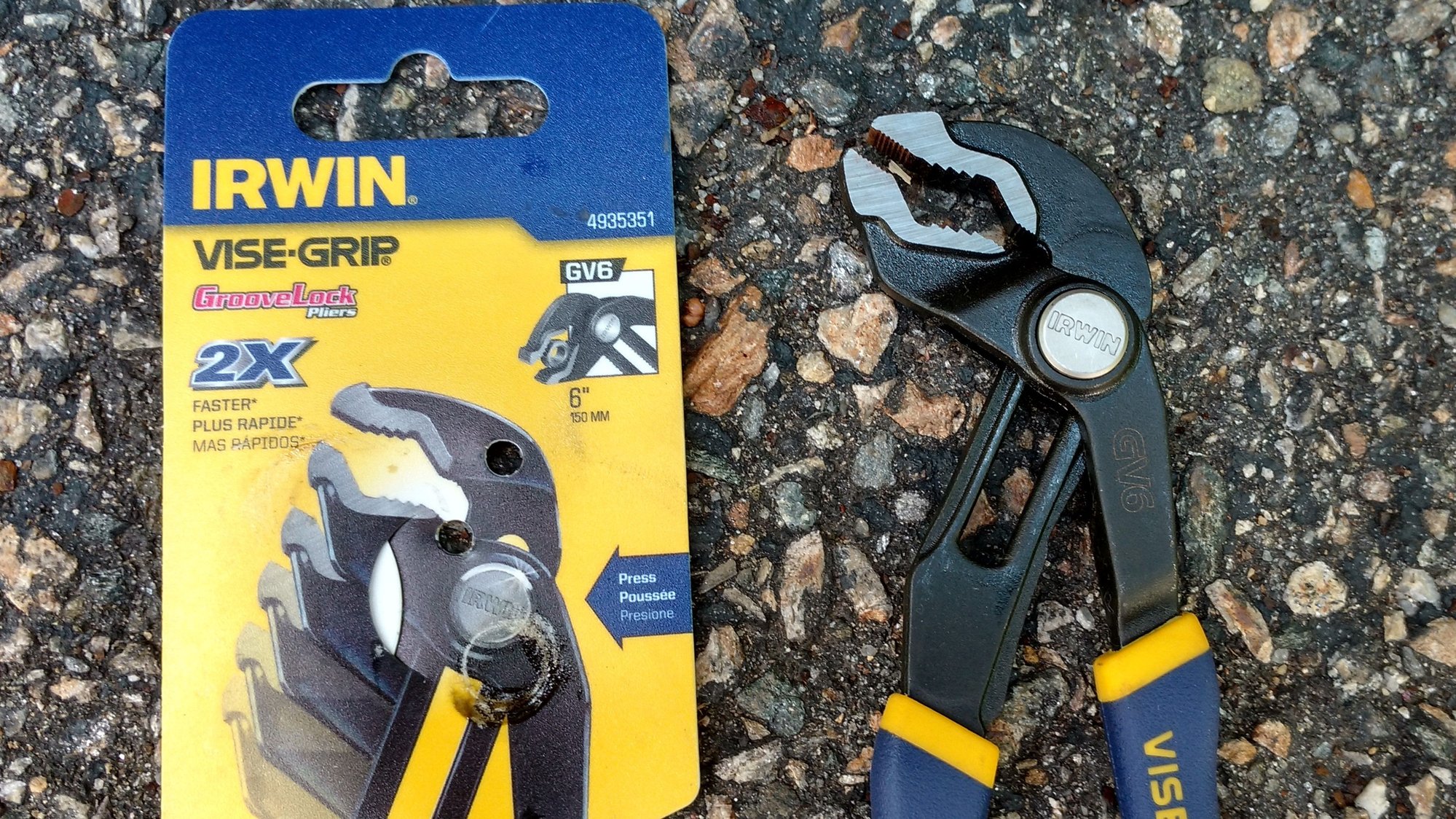

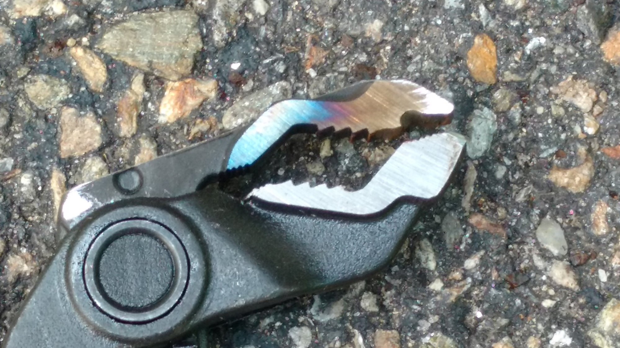

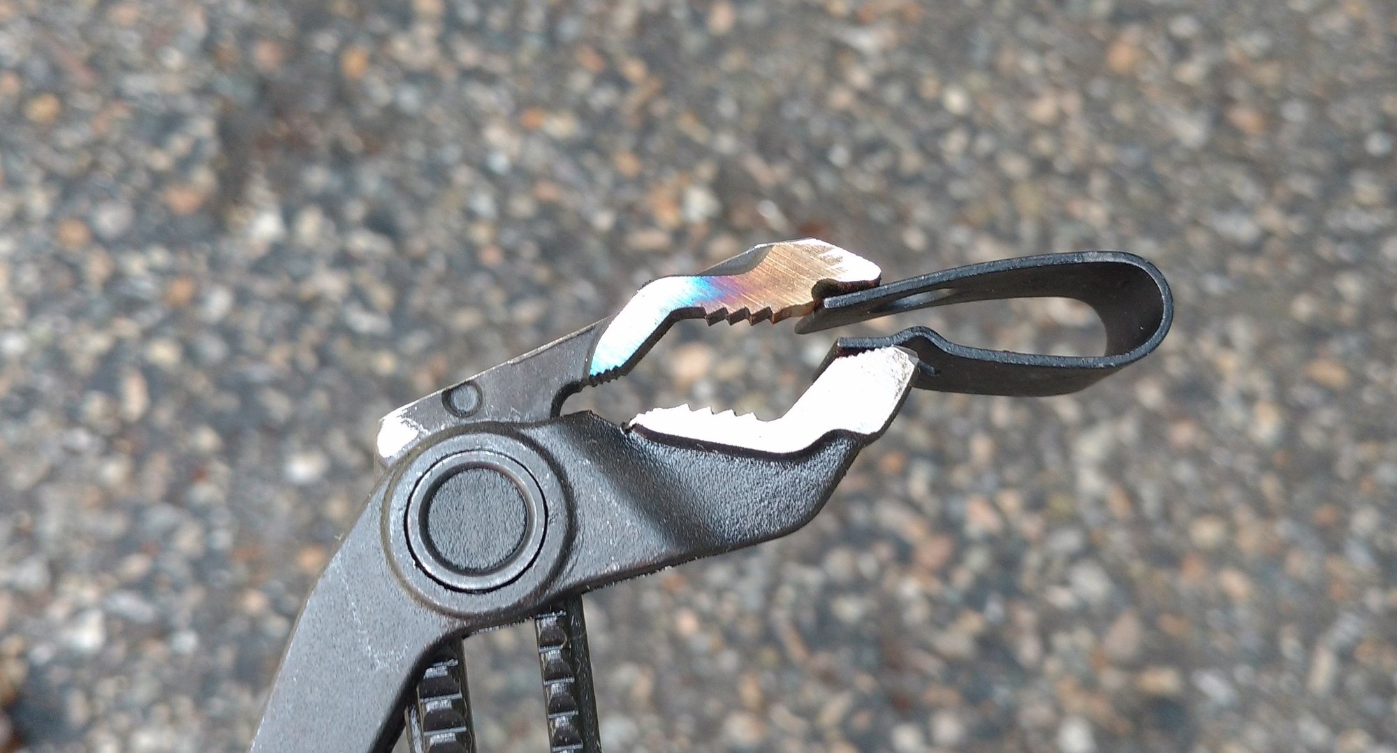

And since my first post and it is a question about brakes, I'll contribute something useful. Attached is pics of pliers that I bought and modified with a die grinder/cutoff wheel this past weekend. Installing the retaining springs for the parking shoes was frustrating enough that I gave up and ran to the hardware store looking for anything that might help. With these I can R&R the parking brake shoes in about 5 minutes. Wear safety glasses because if the spring flies out it goes straight for your face.
