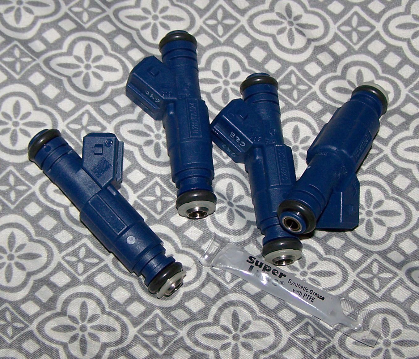

As for MPG you wouldn't see any but you may pick up a little power.

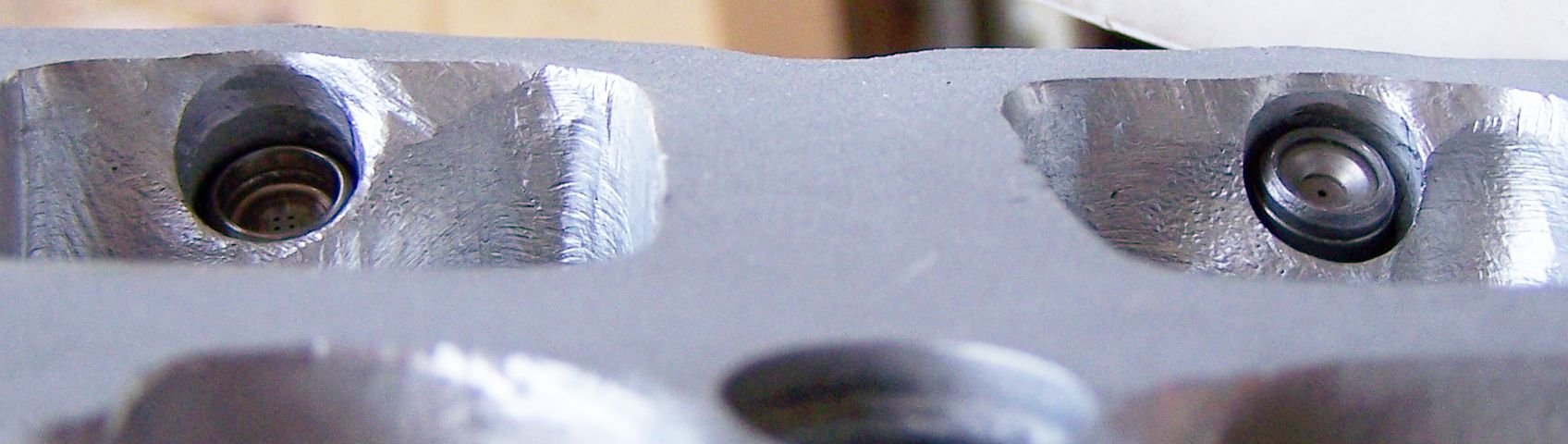

I installed them in my 2.5 but I also did extensive manifold porting as it was needed for the 4 hole injector. They say no modification needed but you do if you want any benefit. If your engine, intake manifold and heads were designed for a one hole injector your best bet is to stay with the same.
I will say the 4 hole for your engine may differ from my experience no modification may be needed.
But this still applies (your engine, intake manifold and heads were designed for a one hole injector)
