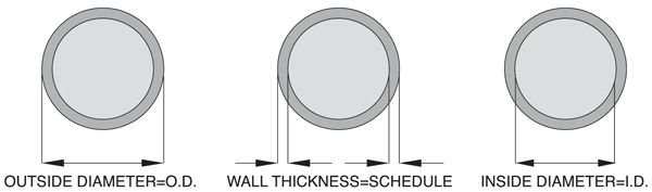

A one person bleeder works great many videos available and its cheap buy some Silicone hose on ebay for the needed line about 3 feet of 4mm thats ID not OD 5mm may work but a loose fit.
ID= inside diameter
OD= outside diameter
