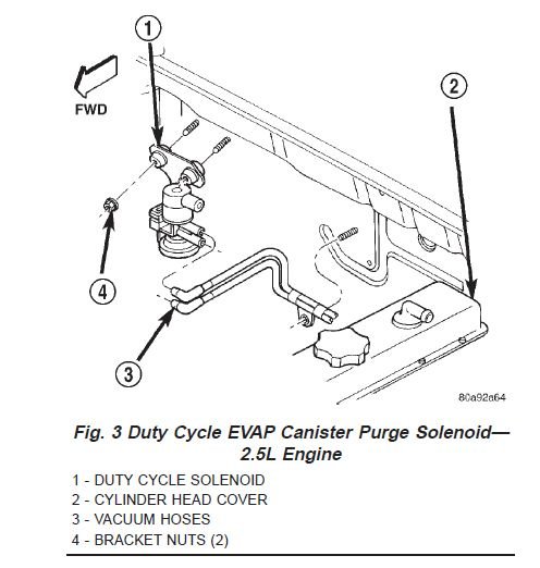

I will say this in all the service manuals documentation of any kind for the 2.5 is crap at best. They usually show a generic picture/diagram that covers all engines the Dakota came with. This dosent work so well with anything related to the 2.5 engines operation.
I can tell that evap diagram is not how the 2.5 is setup

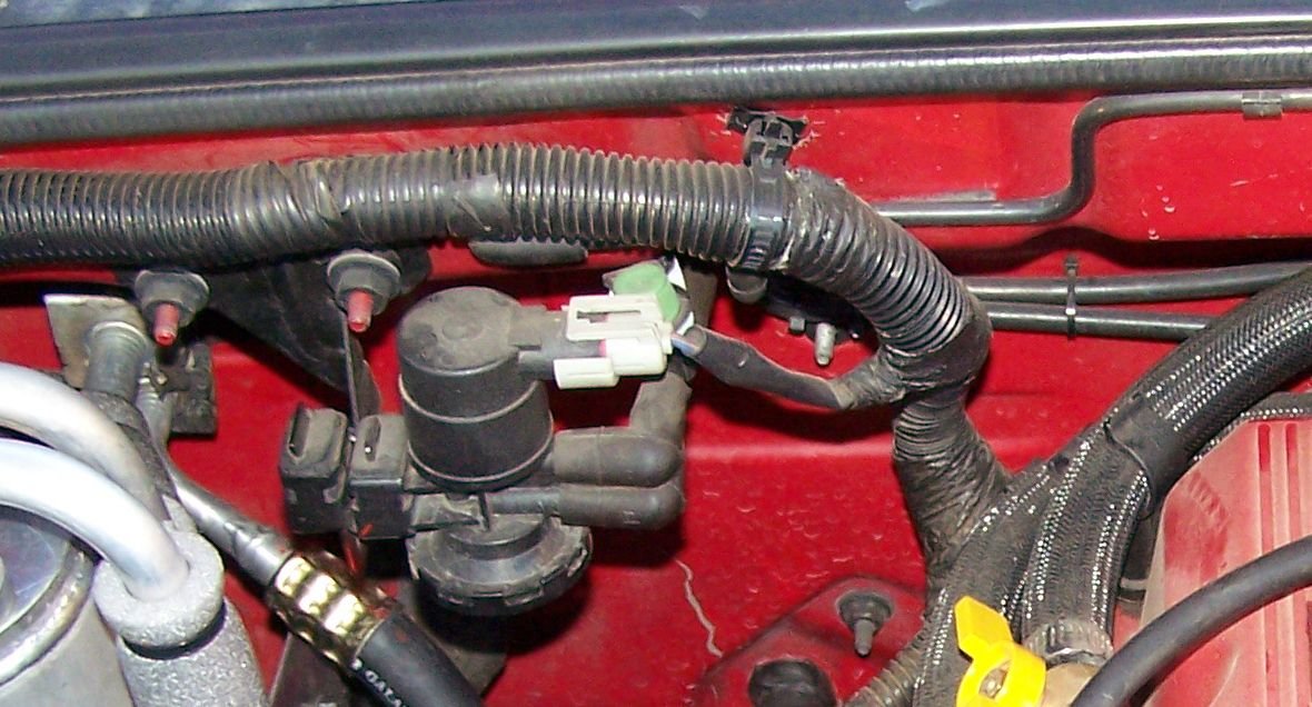

The EVAP canister purge solenoid on a 98 Dakota is located on the firewall this is how it looks and one line goes to the intake manifold other to the charcoal tank.
To be 100% sure I need to look at it but I have the flu so thats not going to happen.
