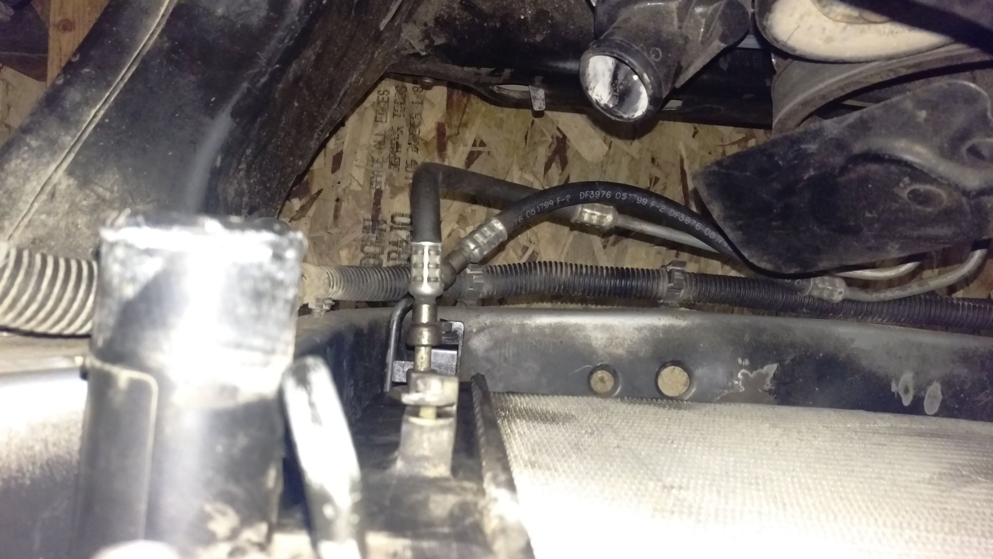

The other item I was concerned with on this year was where the transmission lines tie into on the radiator. As it stands I found a 10-12 inch bent up oil line tube that just didn'
t make since to me until I put the oil cooler on the back of the radiator. That is when I realized the oil cooler in the radiator and the added one in front were piped in series. The small tube tied the two together and one from the trans went into the radiator and the second had a bent tube that went to the front and tied into the added oil cooler.
Now the next question is I have several electrical connections that the plastic keeper had broken when I removed it or when I replaced it. The critical one is on the side of the transmission. I am sure it is tight but one of the ears broke off when I flipped the bail over it to pull it tight. My concern is vibrating loose and getting water in it. This is the 30-40 pin connection on the driver side of the transmission. One other is on the spark plug post and or the fuel injector. Do I use wire ties and lash them down the best I can or is there a more factory solution?
This is the small 12 inch factory tube that goes from the inside radiator oil cooler point back around the side to the from added oil cooler.
Top line is one end of the 12 inch factory tube. The bottom line goes back to the transmission
The bottom line was the hardest to get through the small area without breaking, kinking, or mashing the end of the tube.
The top line is the 12 inch factory tube. The bottom goes back to the tranny. The other is from the tranny and wraps around the side of the radiator and connects to the added oil cooler.
