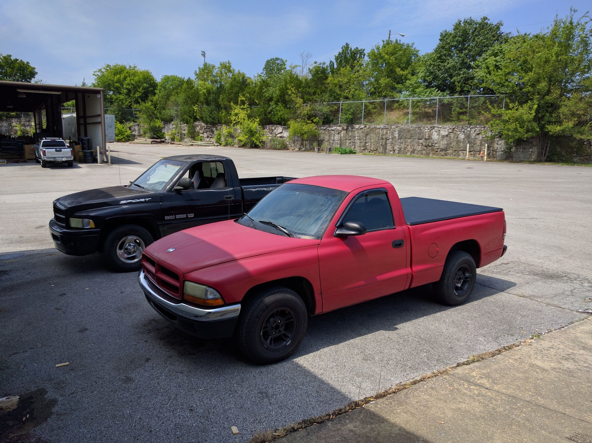

After a bit of investigation, seems to be a Mopar Performance set. Oddly enough, now that it's changed, the exhaust sounds better... I guess the computer can get the timing right... The exhaust is now louder than the engine at idle, and actually kinda sounds like a V8. Friend at work drives a 99 Ram 1500 Sport 5.2L, and my 3.9L sounds like a quieter version of it.
Bonus: Picture of said Ram and my Dakota (old picture, when I got the tonneau, before the grill, lugnuts, and freshening the wheels)
