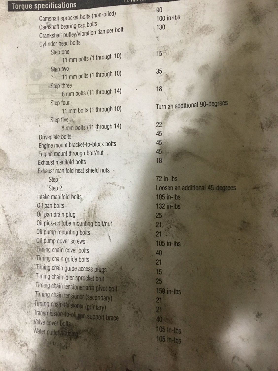

1) Bolts 1-10, 15 ft-lbs
2) Bolts 1-10, 35 ft-lbs
3) Bolts 11-14, 18 ft-lbs
4) Bolts 1-10, Turn additional 90 degrees
5 Bolts 11-14, 22 ft-lbs.
For step 4, I have a torque wrench with a built in angle reader, otherwise you will need a GOOD torque angle gauge. Aluminum heads must be torqued on very precisely for a proper seal.

Here is torque specs for things you will need. Additionally, spark plugs on this engine should be torqued to 20 lb-fts
