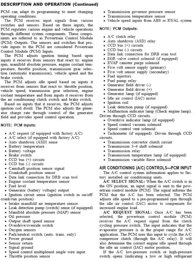

just about all sensor. its how OBD2 works. chrysler call it CCD bus (Chrysler Colision Detection ). they all have the same thing just different name.
the pcm get sensors input in volt or omh , and return it as CCD ( pulse ) to control other things.
it's called multiplexed wires.
if a sensor is internally short , it send wrong voltage to PCM that send wrong pulse on the CCD bus, wich can make almost everything on the CCD bus act weird.
this mean your oxygen sensor can be in perfect condition , but pcm throw a code for it and in reality the problem is another sensor or a shorted wire.
i have a friend with a durango that has a faulty cluster. he had many codes related to ignition and sensors. he swapped the cluster and everything was fine.
here is a screenshot from pdf FSM. can't upload it with this 75Gb plan.
pcm ccd bus

Posts: 87,483
Yep, if it's on the engine, and has an electrical plug, it can cause issues. (except for the coil. it doesn't get its feed from the PCM.)
The cold side of the coil is ground pulsed by the PCM...so yes, even it can cause issues, and has it's own P code. hahahahahahaha
