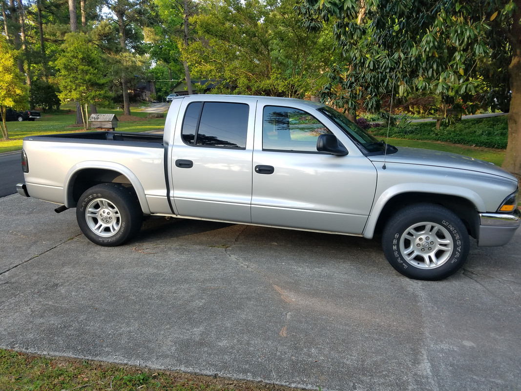

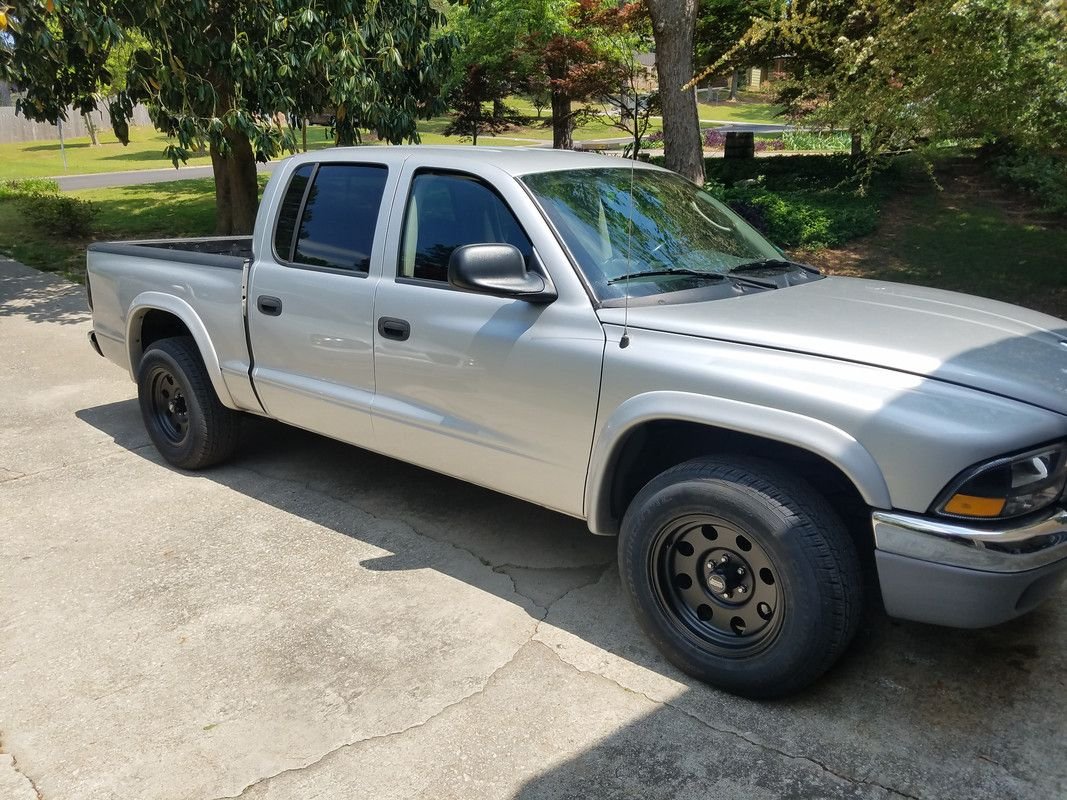

I notice the wheels in your avatar are black, could you post a photo of them?
I have been thinking of doing the same for a year now and would like to visualize that.
Thank You

Here you go....
And here is a before....
