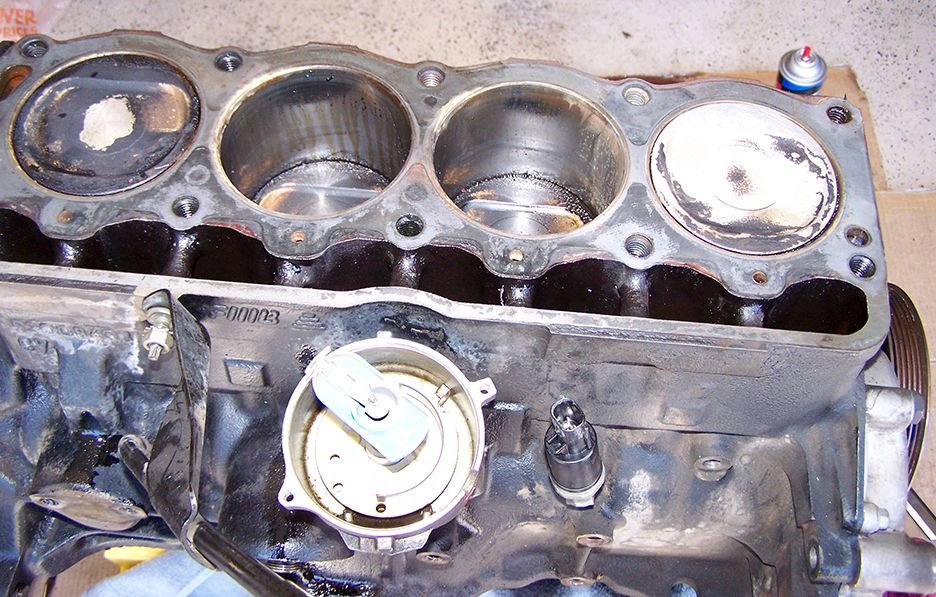

OK my update

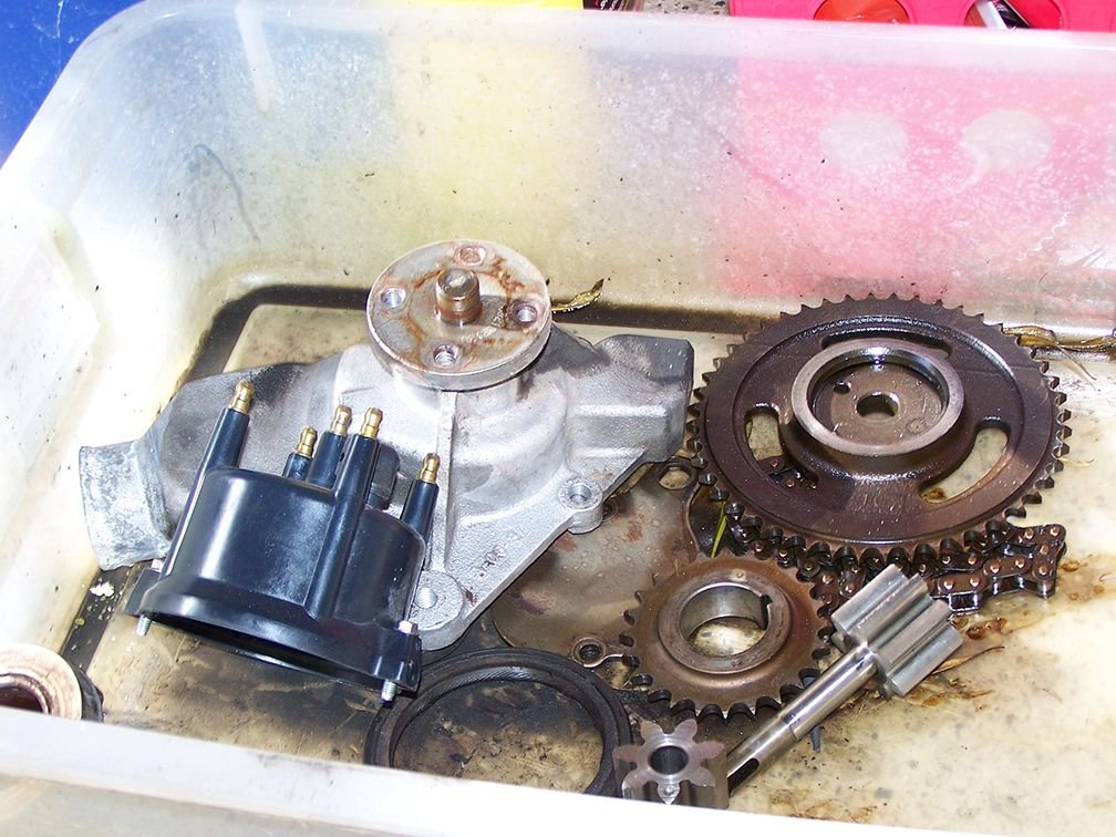

Engine bores smooth as glass pistons worn some and rod bearings hammered.
Main bearings look great timing looked OK but tensioner maxed out but chain taught

More Pic's talk later

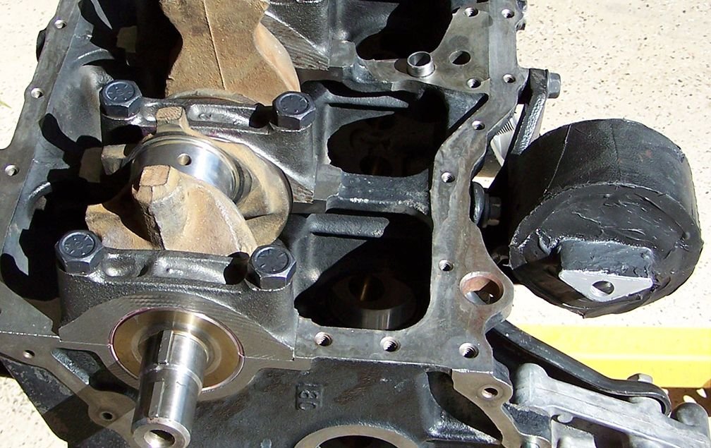

OK an update
Pistons ready
Crank in
Pistons in
My polyurethane engine mount fix
Old junk

Update I ran into a problem the engine started binding up turned by hand and I wasn't happy with the rear crank seal.
So I disassembled the engine to see what was going on I finally decided to change the main bearings with a different set and a new rear seal. Its back together and no binding rear seal is a better quality so thats good.
I just installed the engine back in the truck this morning the new head goes in now it was easier to install with the head off to get at the trans bolts.
