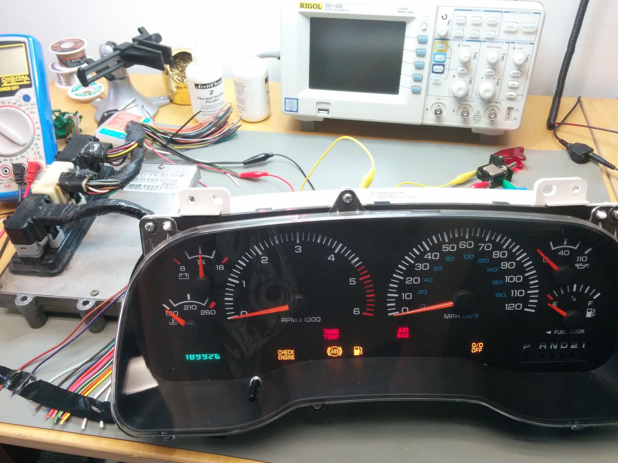

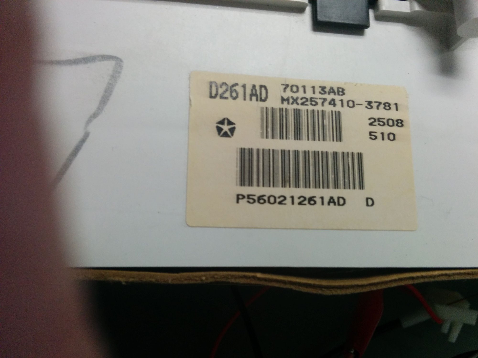

I recommend getting another gauge cluster. They are under 100 bucks on ebay. I have another one from a 98 Dakota I can ship to you. (Friday earliest). Does yours look like this and does it have the same part number?
98 Dakota Gauge Cluster
98 Dakota Gauge Cluster Label
Yes, my gauges look like that but not for an automatic. There are a few at my local salvage yard for manual transmission setup but are for the V-6, not the V-8. I don't know if they would be the same.
I don't think there was a part # sticker on my cluster. I've actually been using the part # stamped into the back of the circuit board of the gauges.
I have been watching this circuit board on E-bay for $29.99 It's for 97-99 Dakota with manual transmission. The last 4 numbers imbedded into the board are not same as mine. it appears to be almost identical to mine however there are one or two circuitry lines that are not identically routed but are essentially ending in the same area as mine.
I just haven't decided to pull the trigger on it yet.
