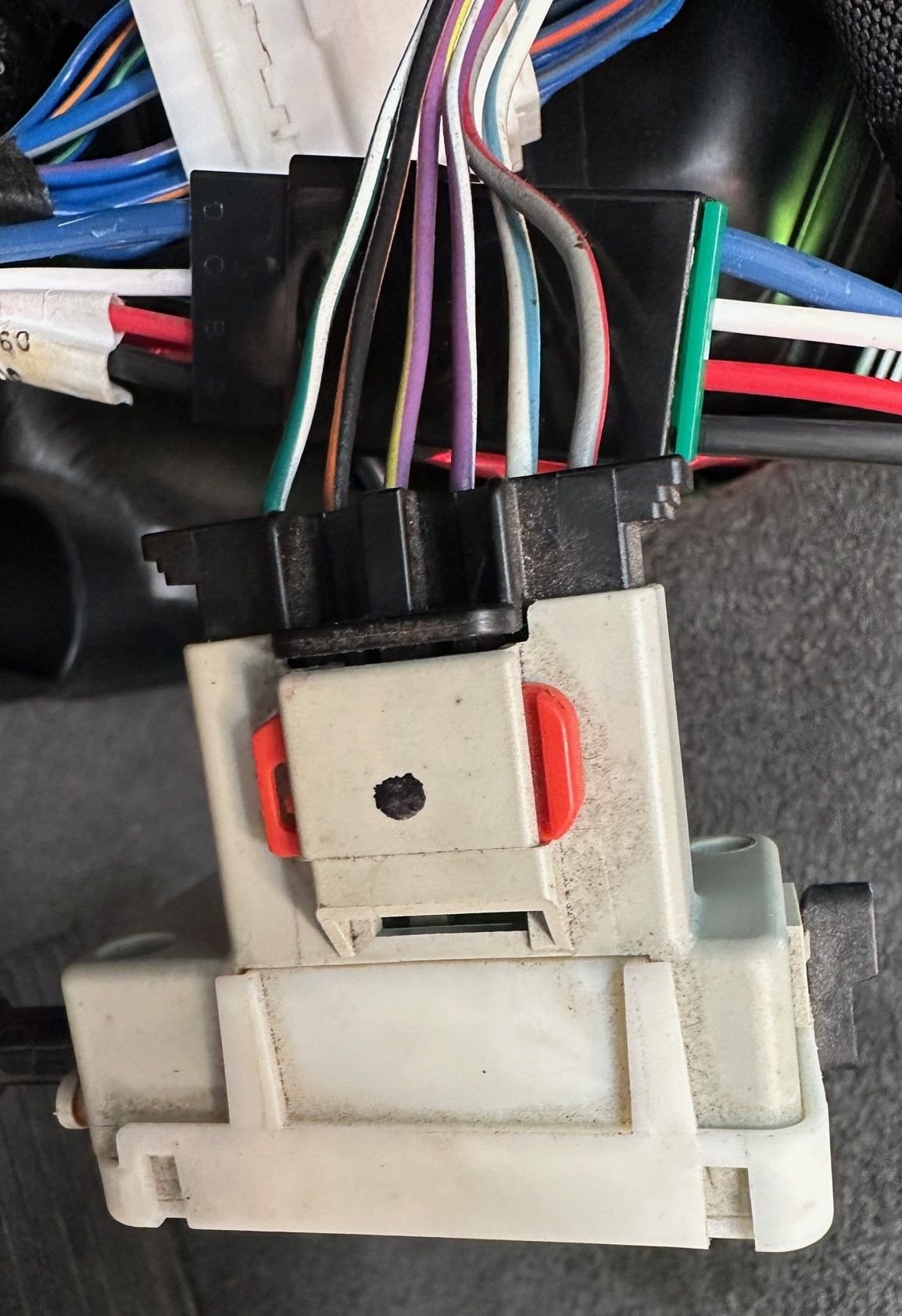

Old Jul 11, 2023 | 12:58 PM
dbartho1's Avatar
dbartho1
Joined: Jul 2023
Posts: 4
Have the same problem, but with my 2005 dodge dakota. I have attached a pic.
