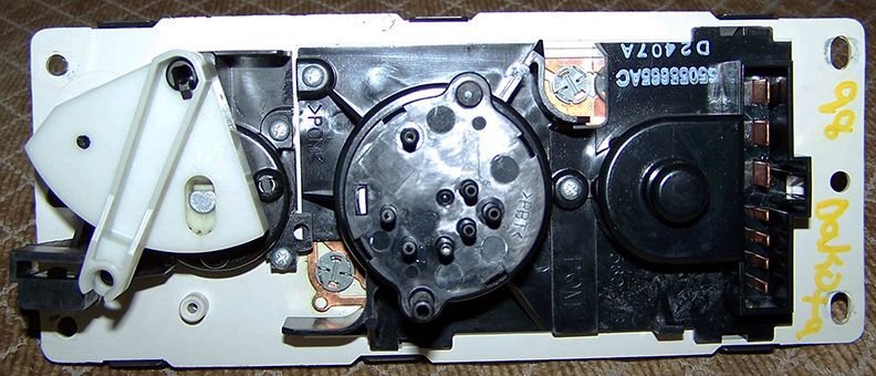

You can just pull the controller out and look it over and test each line its not too hard to pull but the bash bezel must be removed first. It will not come out 100% just some unless you pull the blend vent cable.

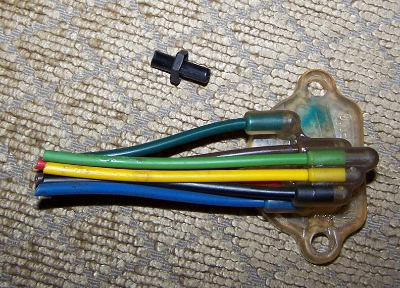

This is the vac connector to the controller this one is a cut off from a junkyard the colored lines are vac lines.

One more Pic for you this the connector plugged in.

Will do it this weekend. Should I use the mighty vac to test the line or just run the truck and feel the lines for vac?

Never tested them myself each line activates a unit or lever for a door.
So sorry no answer
Have you looked up under the dash for the HVAC for damaged vac lines they are color coded I had pictures of each vac unit but cant find them.
