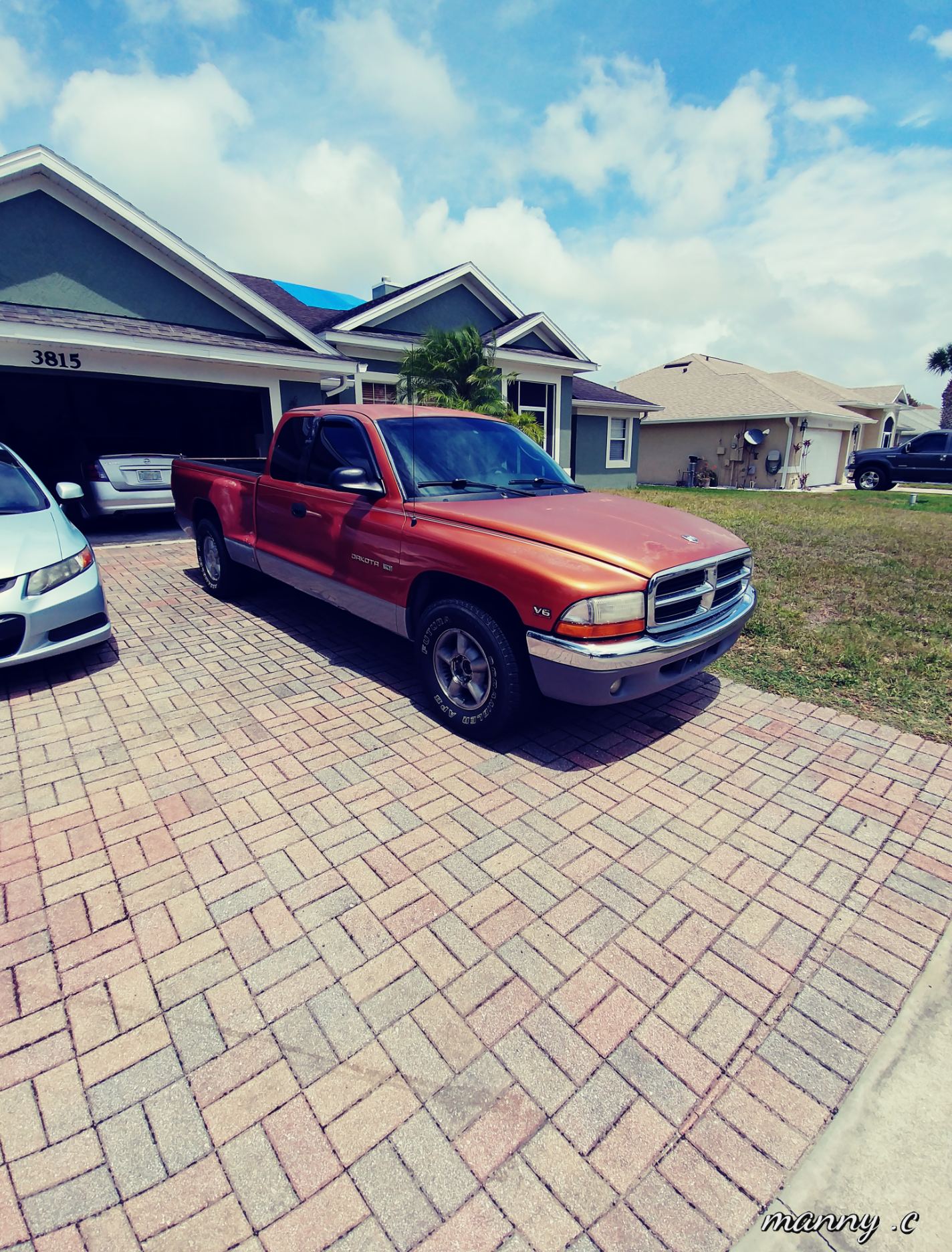

I'm Manny and i own a 2000 Dodge Dakota slt
3.9... V6
error codes just pop up. P0601 & 1492
I think my ECM is going out... Does anyone know where I can get one at a good price.... Thx
