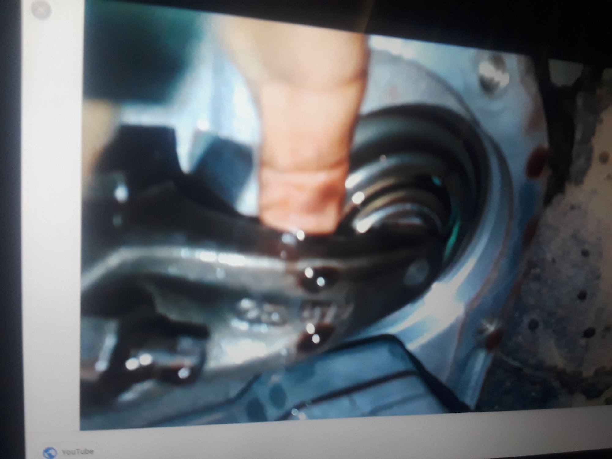

i did see that the servo part at piston can be faulty an the bands can be off also .a shift solonoid too but that should throw a code.iim not getting any codes.
I feel a tad of movement but it's like no hard shift just air like

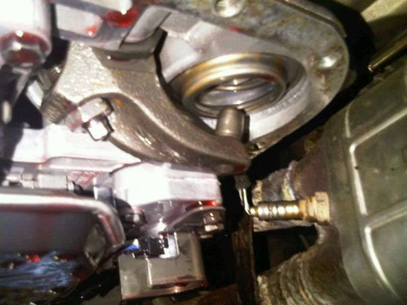

Pic
Here's pic online
