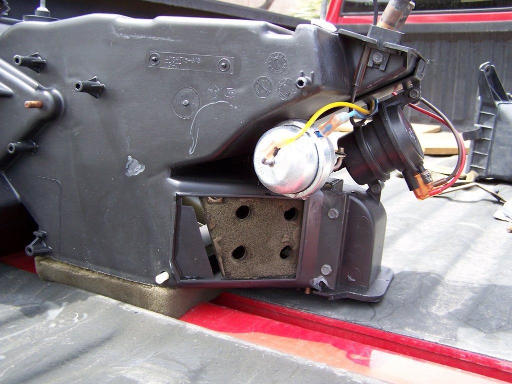

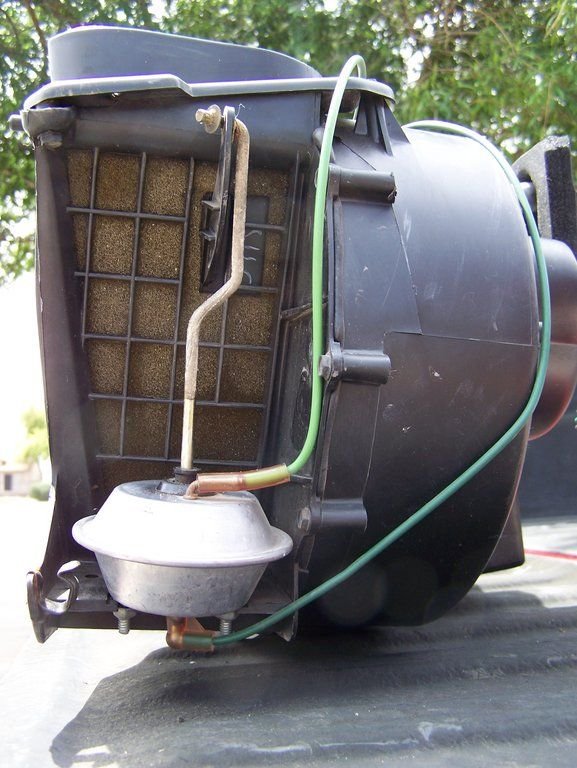

Is it nla from the dealer or all together. Do you know the part number? Is this the correct one?
Old Sep 30, 2018 | 02:13 AM
98DAKAZ's Avatar
98DAKAZ
Joined: Jul 2011
Posts: 4,895
Likes: 35
From: Gilbert, Arizona
Thumbs up
Fresh air door.
other two for floor vent or defrost.
Your blend door is manually operated by cable by the HVAC control on the dash.

Are they all the same actuators?
Old Sep 30, 2018 | 10:31 AM
98DAKAZ's Avatar
98DAKAZ
Joined: Jul 2011
Posts: 4,895
Likes: 35
NO they are all different did you look at the pic's?
Used is your only option

I overlooked the last pic. I have found the black actuator in the last pic. But cant find the silver one in the midde two pics. I might have to wait to replace them because it is getting done in the next couple days and wont be able to get them on time .
