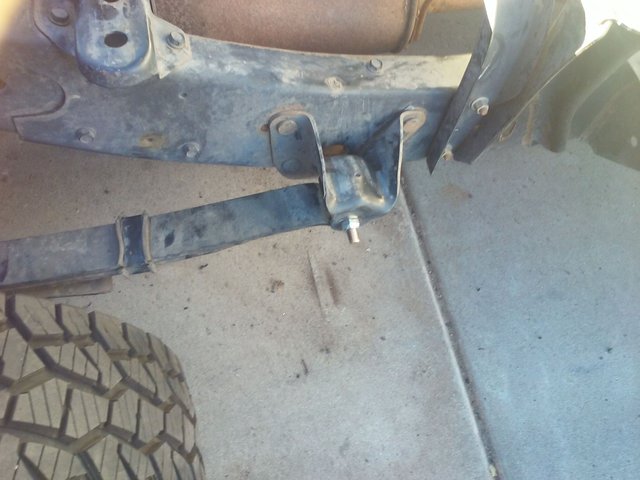

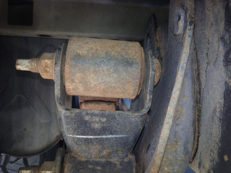

The rear axle is misaligned though. Once I confirmed the measurements on the frame rails, I measured from the inside edge of the brake backing plates to the frame and on the driver's side it is 1/4 inch further out than the passenger side that took the hit. It would need to shift back 1/8th inch toward the passenger side to be even. I called up a local spring shop and they told me to take a close look at the eyebolts and shackles because it isn't common for leaf springs to bend laterally. Sure enough, I think I am going to need to replace them. Here are some pics, note the grease pen marks on both of the shackles. Insurance claim estimator's marks?

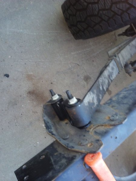

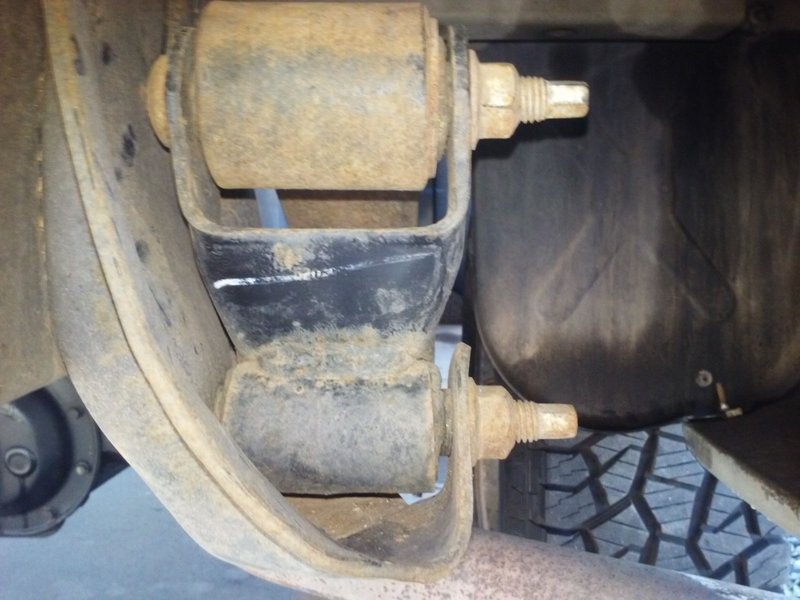

Driver's side front eyebolt. Spring looks slightly rotated
Driver's side shackle looks bent clockwise. upper bolt looks straight.
lower bolt appears bent.
Passenger side shackle. Spring looks rotated clockwise on the bolt. lower bolt could be slightly bent down.
retainer clips showing evidence of shift.

After looking at the springs for a while I decided to just remove them and take them to a local spring shop for their opinion. Right off the bat, they said that the passenger side main spring leaf was no good. Either the impact or the tow truck driver had pulled the spring towards the rear of the truck unrolling the eye. You can see what he was talking about in these pics.
Driver's side
Passenger side (impact side)

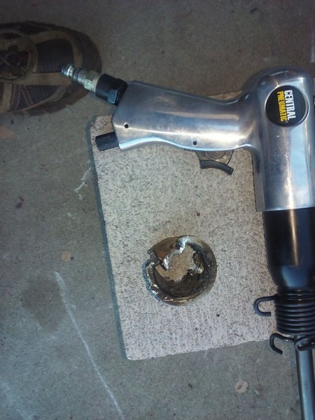

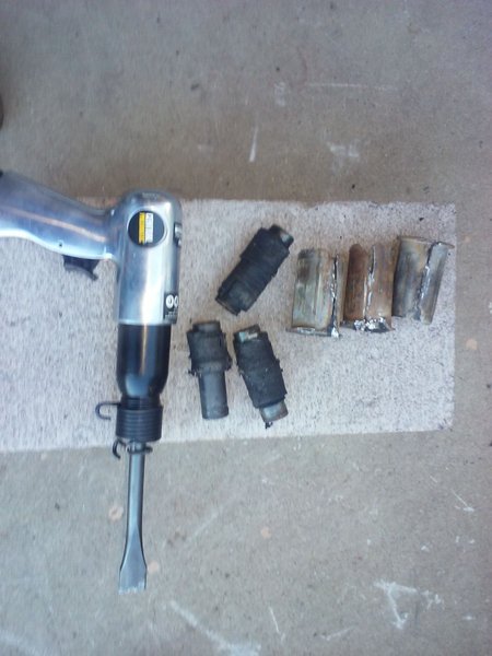

So then I ordered a set of bushings, shackles, ubolts,and hardware for it. This is when the holidays hit and I kinda got off track, but I'm guessing it happens to the best of us, right? Funnily enough, I ended up spending the latter half of Christmas day knocking out and reinstalling the bushings.
In hindsight, I should have gone with Poly bushings, the steel sleeved rubber ones are a bear to R&R.

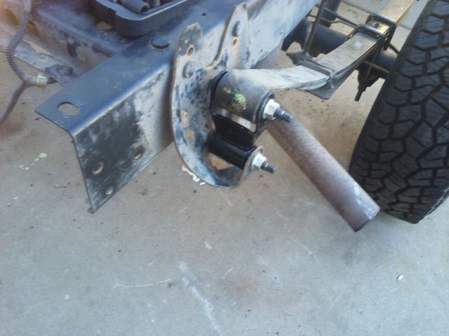

And here it is reassembled and waiting for the bed to be reinstalled:
After everything was torqued down, I did some measuring and the axle is now centered to the frame, no more 1/4" shift to the driver's side. I also measured from the center of the wheel to several points on the frame up under the cab and each time, the measurements were dead on.

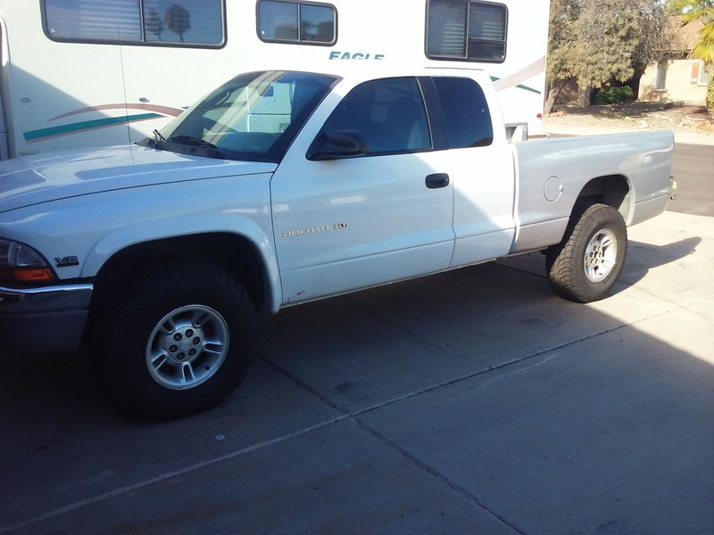

I took it in for inspection to get the salvage title switched to restored salvage. I was thinking it was going to be a pain in the butt, but the officer just inspected it for safety equipment then signed off on it. so I am driving it around now but not full time yet. It still has some issues to work out.
I had to swap out the power steering pump because it was groaning constantly and sometimes the pump acted like it was running dry even though there was plenty of fluid in it. I put a junkyard PS pump in out of a low mileage Durango and it quieted down, but it still feels like it is running dry every once in a while. I am suspecting that I have some sort of leak on the return line which is allowing air to be pulled into the pump instead of fluid. There are no fluid leaks though, and it only happens after I have been driving it for 10 minutes or so. It's a gearbox system, so there might be something wrong with that also.. could use some suggestions..

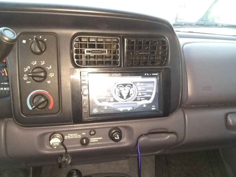

I installed a cheap Chinese android head unit along with an MTX amp, Pioneer sub, and new Cerwin Vega component speakers in the doors. I took the speakers that were in the doors and replaced the ones in the back which were shredded. I did this while I was recovering from the surgery because it wasn't too labor intensive. Sounds great now.
I found a good set of the bigger folding mirrors from a 2001-2003 Durango and wired those in. The plugs are different, but if you compare the wiring diagrams of the older and newer Dakotas, they are easy enough to figure out.
Replaced the lower bumper cover with a painted one that was in good shape. The mounting tabs on old one were torn and the previous owner tried to glue it back into place
I used a plumb to measure off all the body mount bolt heads and marked them on my garage floor. I then measured between those marks and they all matched from the left side to the right. so I am confident that the frame is straight.

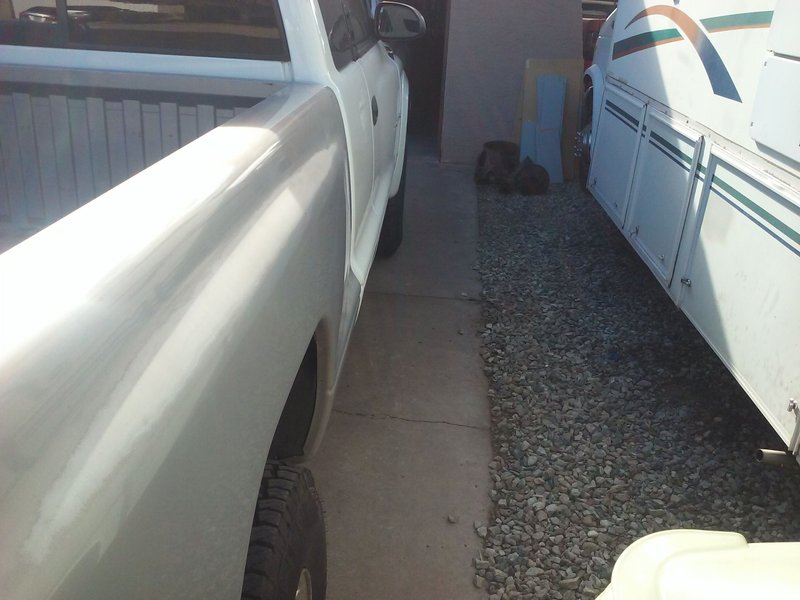

While I was under there, I spotted the problem that was making it look off.. The rear of the cab wasn't centered on the frame. It was shifted to the passenger side by 1/4 inch. After centering the cab on the frame, I re-centered the bed behind it and now the axle doesn't seem like it's poking out the driver's side anymore.
It was also shifting really hard and late. A quick adjustment of the throttle kickdown cable fixed that problem.
