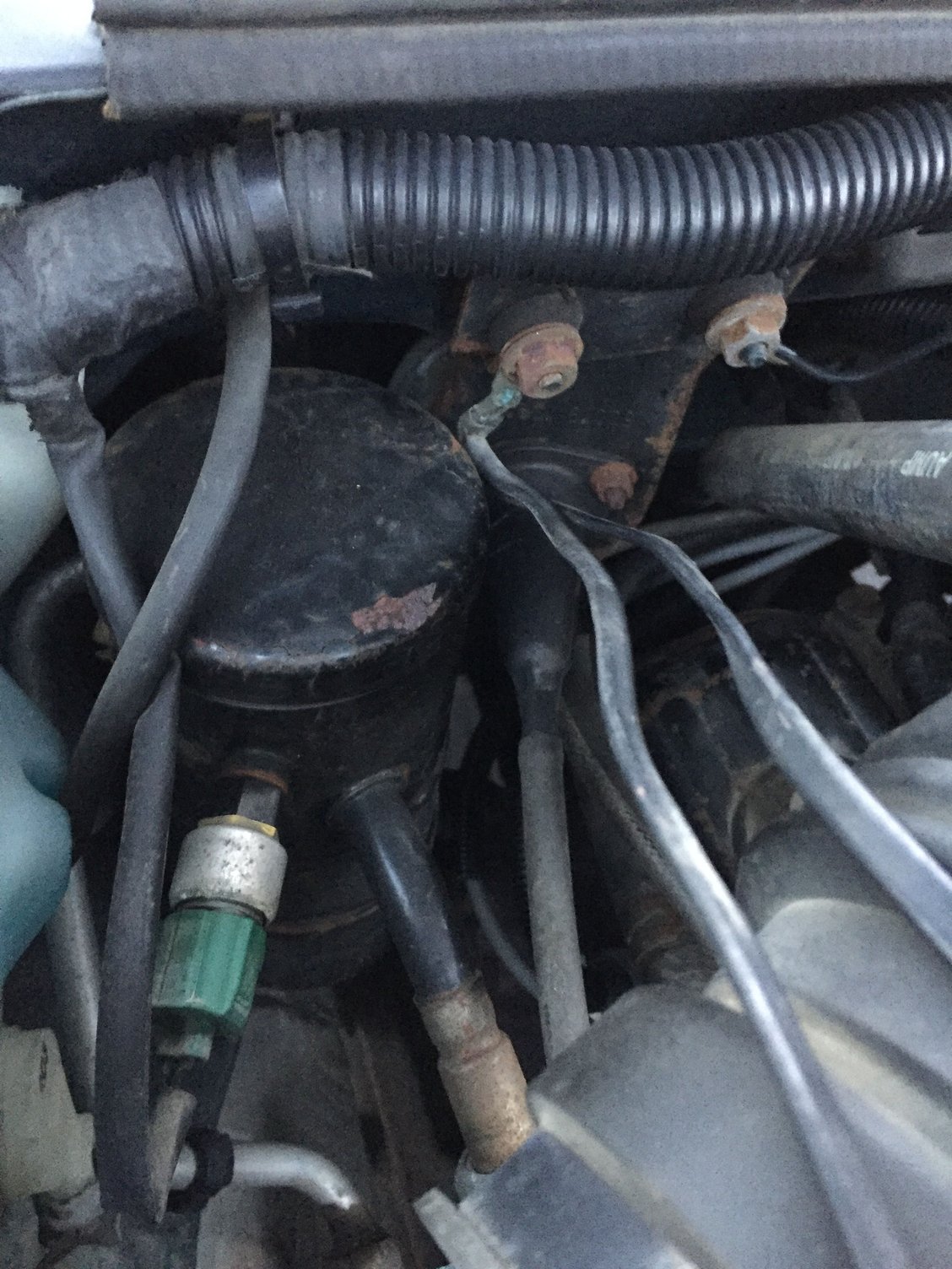

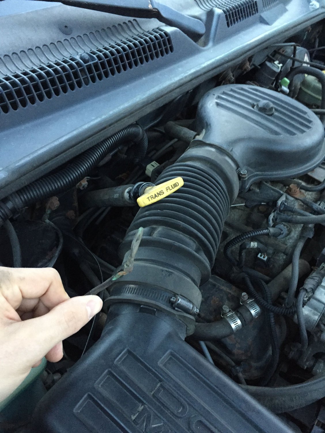

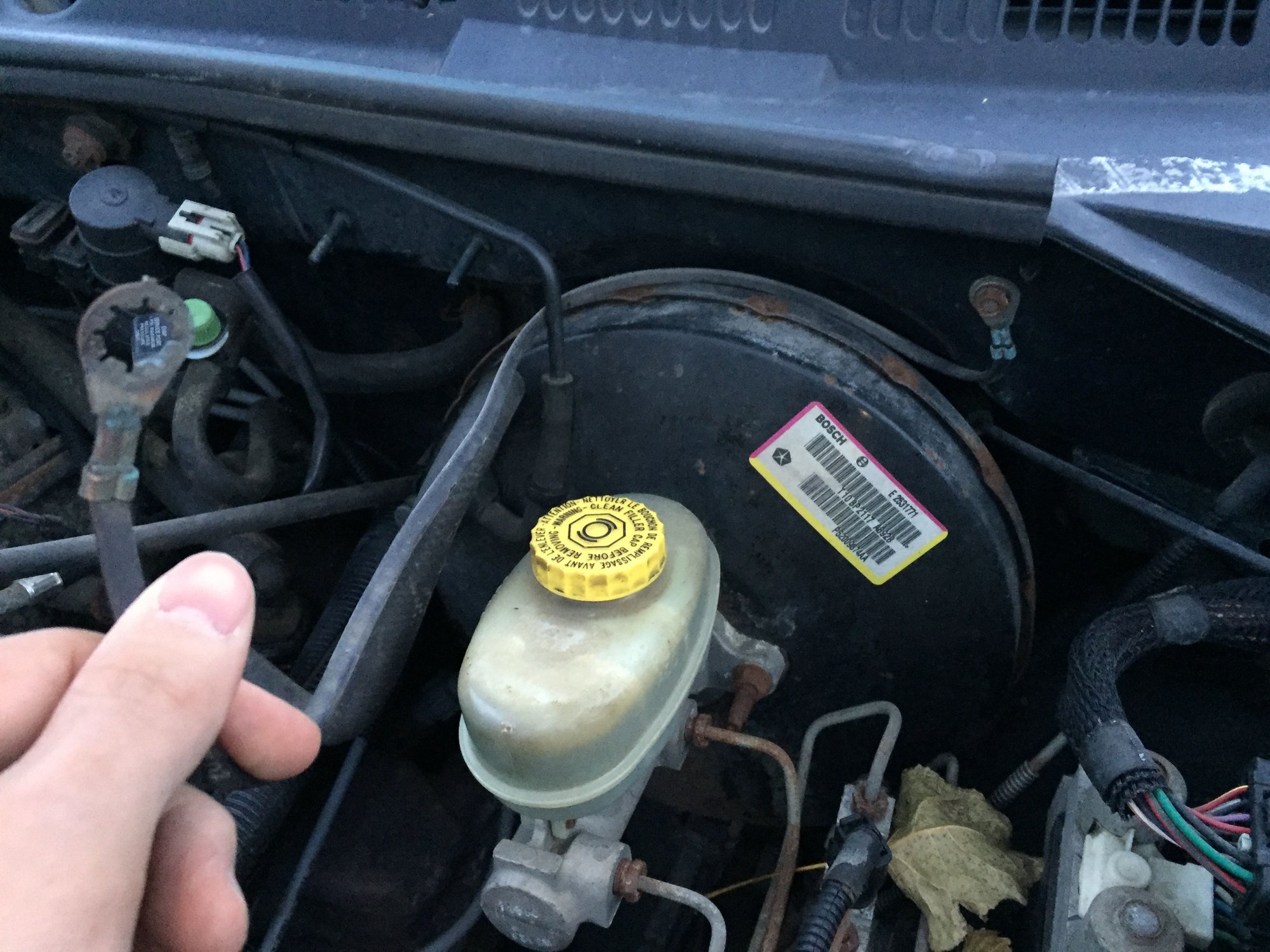

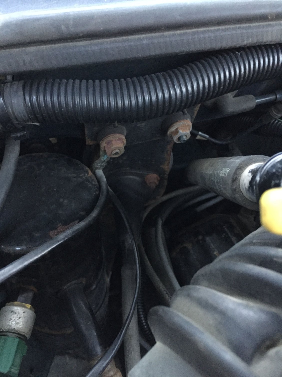

Also heres the wires, help me find their home

They are ground wires just connect to the block yes they are very different ground wires than the usual grounds.

Those are ground wires. Should go to the back of each head.
