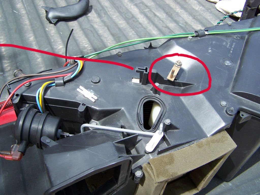

This is were the cable attaches to the blend door.

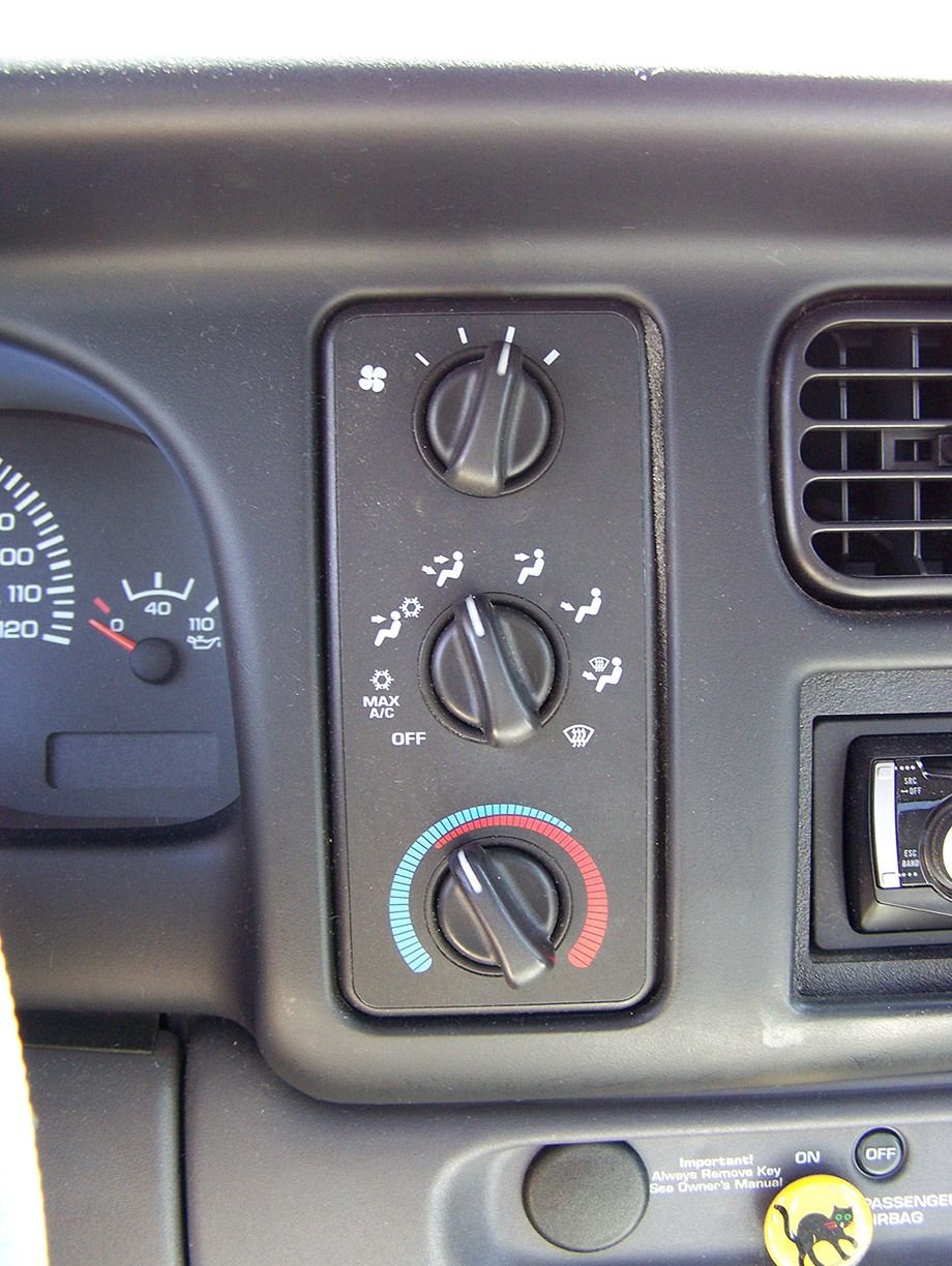

THE CONTROLLER make sure the new/used controller has A/C functions.
JUST OUT OF DASH

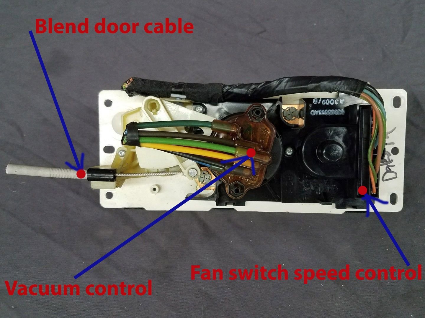

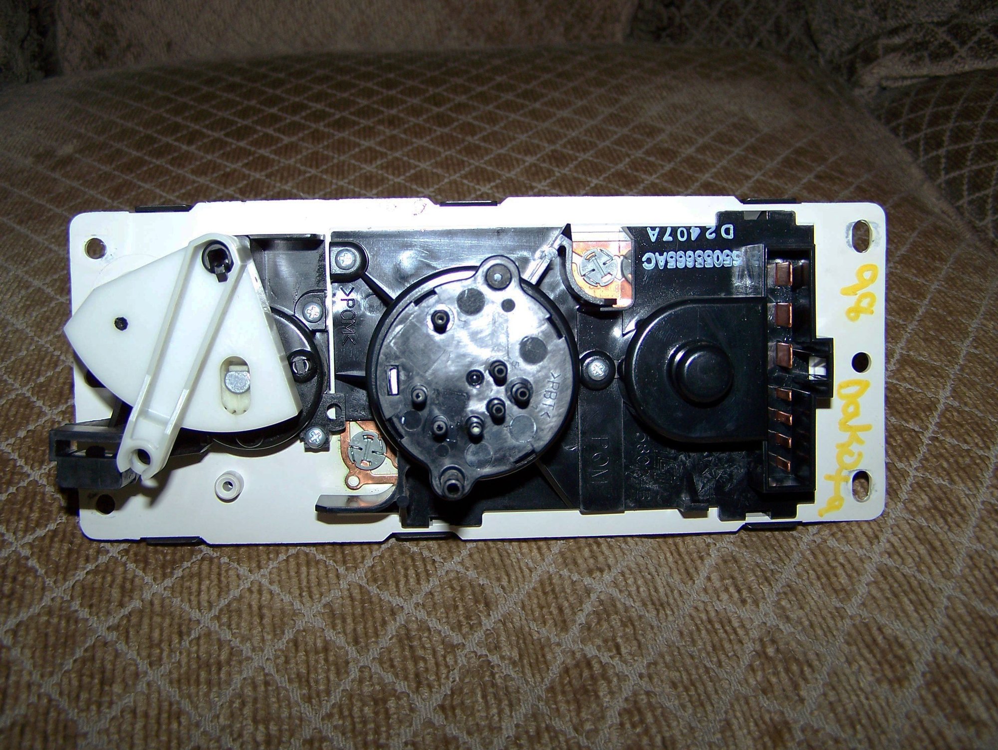

A USED JUNKYARD CONTROLLER the cam looking thing is were the cable attaches.

Awesome pictures help so much with understanding where to look behind the glove box! Its warm this weekend up here so im going to try and get this figured out tomorrow!

They still have a number of used controllers on ebay this is one I found that has all the connectors still on it this helps show you how things attach to it.
